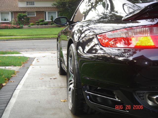

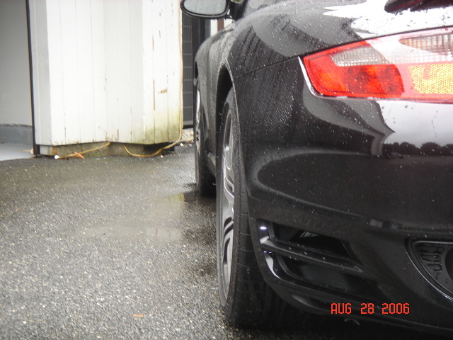

I want to put the Porsche OEM 17mm spacers on the rear wheels of my '08 Turbo with 5mm's on the front. Attached are some Rennlist pics of a 997TT with 15mm's on the rear which I think look fantastic and really fill up the arches much better than stock.
