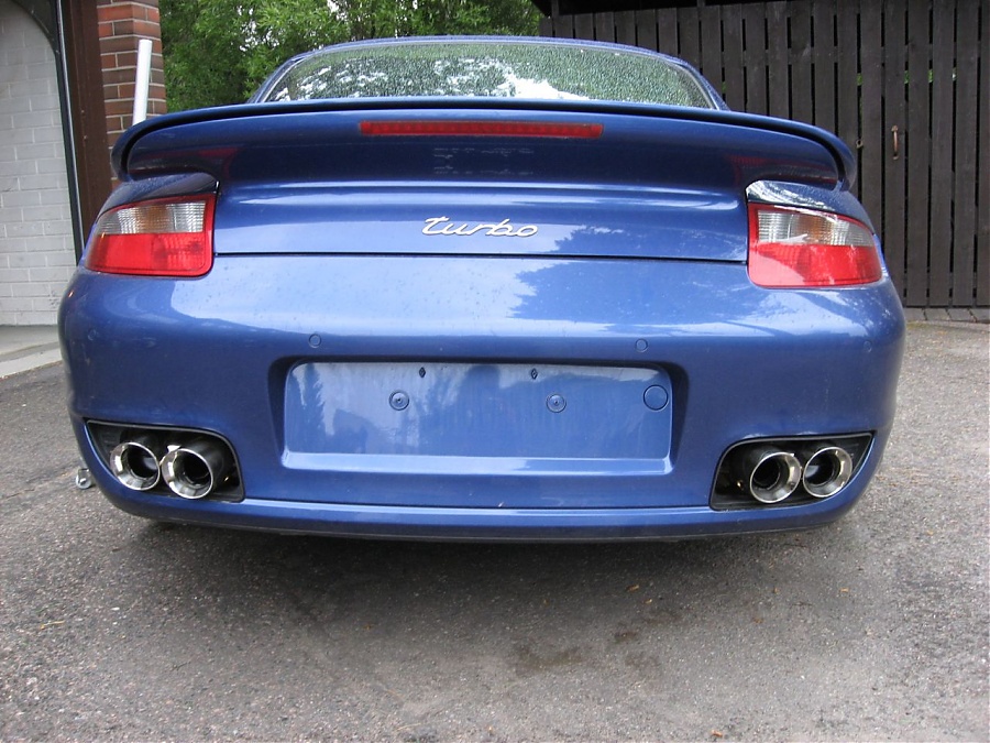

Same thing here! I'm very happy with the sound and overall with the Fabspeed product.
The misalignment was according to friend more in my head than others so I let it go as it is and not to worry about it any more.
Now let's have a competition about who's tips are most misaligned, here's my shot:
-ESu
