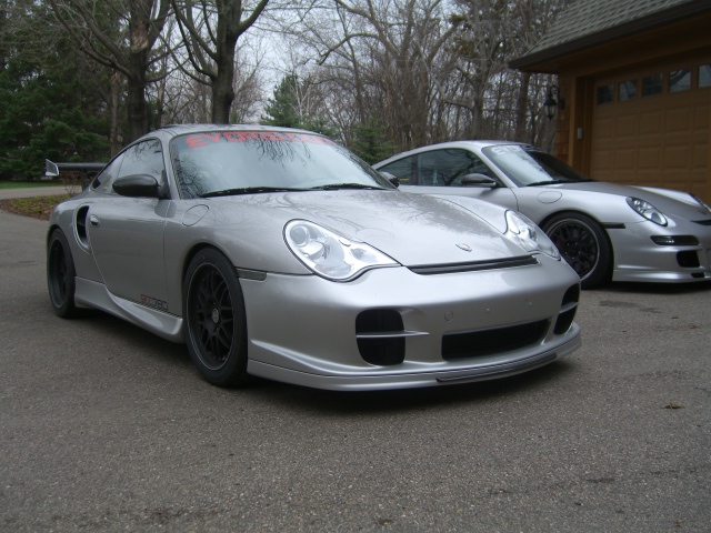

Woodster tries out the 997TT EVOMS
Sharkey,
I can comment if you will. I drove (and did a friendly pull against) yesterday!!
EVOMS (Todd Z's) 997TT (full story will be told by Mike Meyers or Luis Jr/great stuff!).
This car has a very refined power level. It has NO lag and is very torquey and quick.
(Many know that I competed against this car last Oct at the Texas Mile and beat it by
about 3.5 mph). Compared to my car, the EVO 997TT has more power down low, without question and has great drivablity as a result of that. My K24/18g car with all the supporting goodies pulls HARD on TOP and is not as torquey (remember this is a relative thing as my car has lots of torque at any RPM but does not feel at all like this EVO modded VGT turbos, Their car really feels fantastic. I am a believer.
Cheers!
Marty K.
