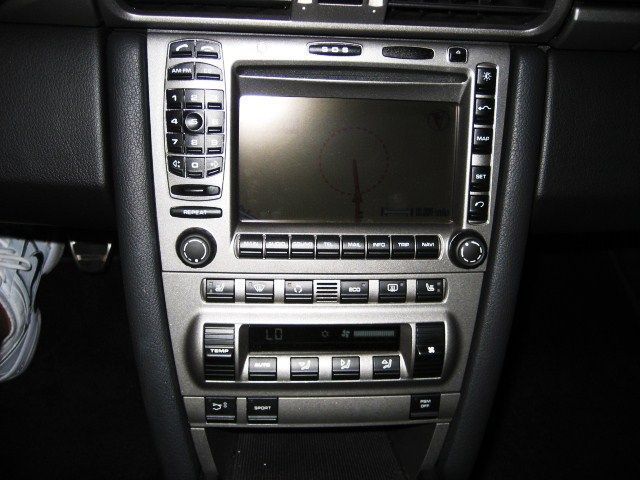

luiscarlos:
If you elect to disable PASM, and really hate having the PASM button that is non functional, you can also swap the control panel for something like this (note PASM button is missing - this photo is form a 05 Carrera without PASM.)
Old Jan 3, 2009 | 07:34 PM
  #85
luiscarlos's Avatar
Joined: Jun 2007
Posts: 1,291
From: N.A.
Rep Power: 80
luiscarlos has much to be proud ofluiscarlos has much to be proud ofluiscarlos has much to be proud ofluiscarlos has much to be proud ofluiscarlos has much to be proud ofluiscarlos has much to be proud ofluiscarlos has much to be proud ofluiscarlos has much to be proud of
That is anice idea in case I am really happy with the KW,s
Thanks
