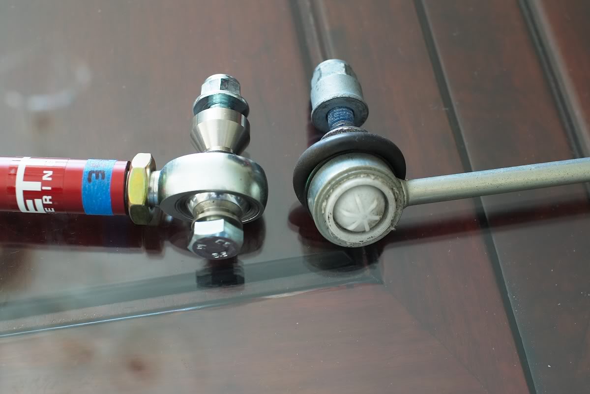

Not for DaBraat but for others new to this: Picture of metallic Heim joint versus Polyurethane stock bushing below. The metallic joint improves handling feel and precision, but over bumps for example the car would make a "crack" noise, instead of a "thud." Without question there is an increase in noise and harshness, to trade-off for handling precision. Don't get me wrong, I *love* the Tarett heim joint drop link in my car, makes the car very planted and the rear secure in high speed turns, but it does increase noise and stiffness. Lightly for me, but YMMV.
Rarely talked about also is the fact that heim joint is a wear item. They wear and become loose over time and you do have to check them and replace if/when necessary. For the drop link, it's easy; but for the other links (dog bones), not so easy to check on your own.
