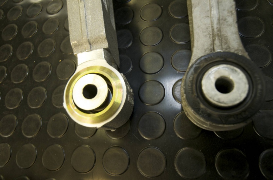

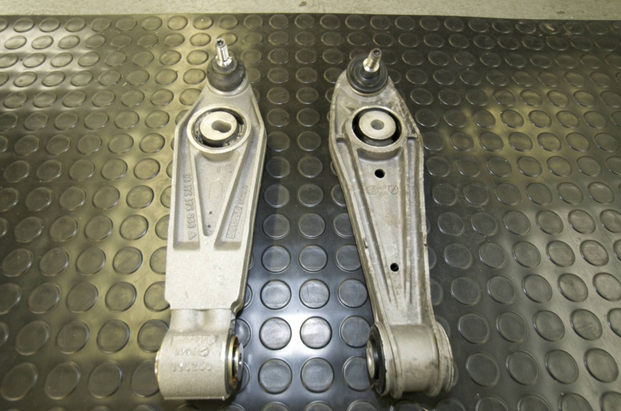

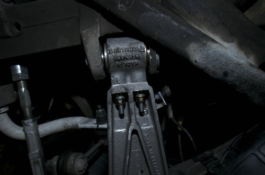

At S-Car-Go in San Rafael, CA. I’m having installed, Porsche Cup lower control arms with TRG monoball bushings swapped in place of the stock ones. Also installed are TRG rear tow arms with monoball ends.
Additionally, I’m having aluminum tubes made that will take the place of the EVOMS hoses coming out of the intercoolers that lead to the turbos. One hose split and the replacement hose fit so poorly it came off. Since the new and old hoses matched I decided to go with a better solution. The boost should rise quicker without an initial loss of boost pressure soaked up by the expanding hoses.
The Cup control arm is a two-piece affair that allows camber adjustments by way of shims installed in-between the two pieces. In the first picture you can see the two attached pieces (the small piece with swapped TRG monoballs) without shims. The other bushing inside the arm (thrust arm bushing) is a TRG monoball swapped for the stock one. The other arm is my old stock one.
So far, one rear corner has been done. I’ll report on the handling once I get the car back.
