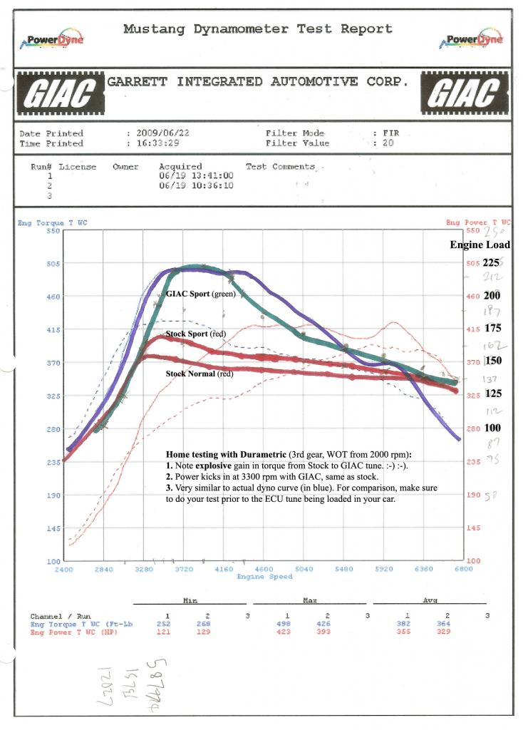

Repost: Thanks to Mod Extraordinaire bbywu's fantastic help, and TTdude's explanation, I was able to run the following tests and graph the result. As always, any expert please feel free to correct as needed.
This particular post is not about power level per se (although that is exactly what I am measuring), but more about testing how well average Joe's Durametric street datalogging approximates pro tuner's dyno torque curve. Why is it important to me? If the match is close, it is evidence that this simple test could be used not only to double check on your tuner's alteration to the program, but also to check any components (header, plenum, exhaust, etc.) you add to see if someone is blowing smoke up the a** (supposedly an actual attempted treatment for drowning in 18th century Europe :-)).
There were several limitations: the 2 test were done 4 years apart in vastly different conditions, this was my first time with Durametric and the number of runs were limited and were done in 3rd gear, not 4th gear, as I don't want to go to jail :-), etc.
Dyno: done in 6/2009, fan cooling with car stationary, 4th gear WOT on dyno, cooler ambient temp.
Durametric datalog: done in 5/2013, real world cooling with car moving, 3rd gear WOT on non-leveled road, hot desert day. I tried to emulate the dyno run by starting at 2000 rpm, then bam, pedal to floor all the way, until red line (dyno was done same way, except in 4th gear).
I did a total of 5 runs or so, a mixture of stock program and GIAC program. In one of the runs, GIAC in Sport mode, the clutch slipped.
Given the vastly difference conditions, I was impressed by the result and how consistent Durametric engine load value is. In both runs, the peak engine load hit 220. The graph of engine load versus torque are very close on up stroke and the maximum values of torque and engine load hit at near identical rpm around 3500 rpm. The shapes don't match perfectly but I am certain with more runs, I would be able to produce more consistent results, enough to test components and tuners.
(PS Error in picture below, the stock torque curve is the one in blue with dash, not the red one.)

Some thoughts from this Durametric rookie:
1. Obviously this is a powerful tool, but I didn't know it was so much fun, and graphing the data makes it much easier for amateurs like me to see. IMHO, it is important to graph your engine load curve; this is the bottom line!!
2. For those who are doing OBDII tuning, actually, for anyone with an ECU tune period, if you are the OCD type and want perfection and want to know what the tuners are doing to your car, I think it would be a great idea to overlay your AFR curve, boost curve, and timing angle on top of this curve. I think it's important to graph and watch at least the AFR curve.
I didn't have time to do the following but I would do at least 4-5 runs the same way: 2000 rpm, then WOT to red line, 3rd or 4th gear. There *are* variations among the runs and to be sure, I think you need to do a few runs to see a pattern and to be certain result is valid.
3. It's important to do before and after curves as always. The GIAC tune in my car has a button that returns the car to stock ECU program so it is easy to do, but if your tune doesn't do this, I think it's a good idea to do Durametric curve *before* loading the tune so you could compare before and after.
4. I've frequently mentioned unless you wear a skirt
(kidding and don't mean to be a chauvinistic p., Sabine could kick my derriere 24/7 with one hand, and maybe even one foot LOL, with PDK car of course), our Turbo is meant to be driven above 3000 rpm as the car has serious lag problem below. Now you see direct evidence why. Even with a WOT, starting at 2000 rpm, the boost and torque do not rise to serious level until 3000 and peak torque doesn't arrive even later, at 3350 rpm in my case with GIAC Sport.

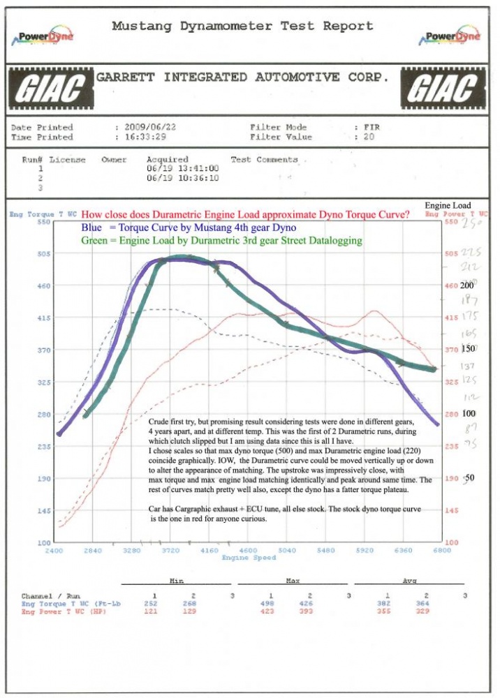

Dyno result and my confirmation by Durametric testing (clutch did slip during Durametric and possibly Dyno):
Note significant build-up of torque early on at 3300 rpm which is same as stock (important for street driving), and nice wide torque plateau
. The car is a "humble" stage 2: simple tune + exhaust + lousy 91 California fuel, and yet you could clearly see what a HUGE difference this simple change makes.
The Durametric testing is done by myself so there is no mucking around with the data. What a powerful and fun tool.

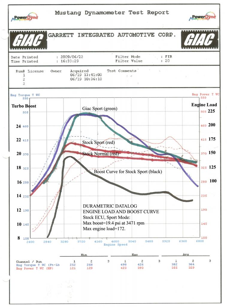

Boost curve, finally. Now we are looking at the "home-made version"
(Durametric based, not dyno based) of the charts that tuners look at when they tune the car. If you have questions about your tune (I don't - just doing this out of curiosity), I would graph AFR curve on top of these also.
Graphing gives fantastic visual clues as to what is going with your tune. Don't just look at the number, graph them!
