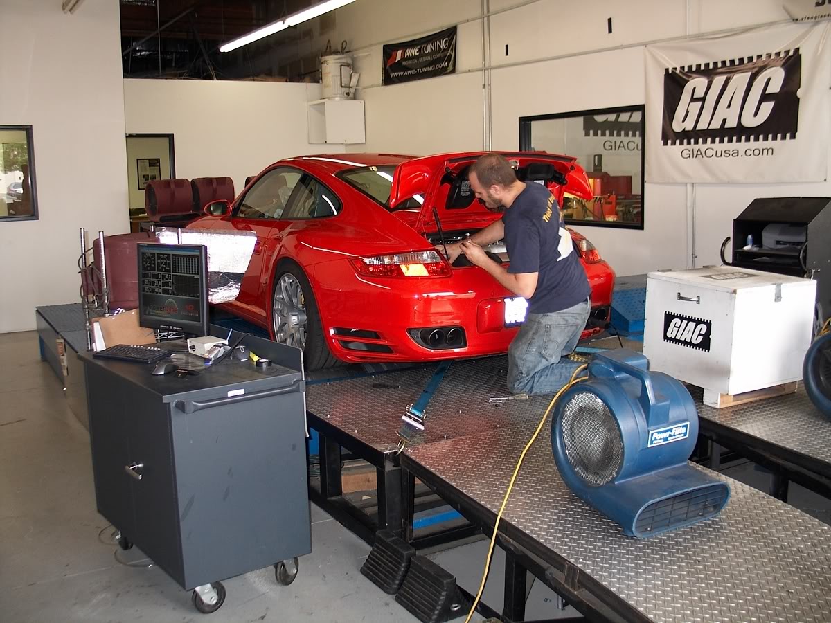

Picture of the flash loader:
https://www.6speedonline.com/forums/...ine=1366306020
https://www.6speedonline.com/forums/...ine=1399740331
cannga 06-20-2009 06:42 PM
1 Attachment(s)
Setting up and adding measuring instruments (that's my car's test "driver" btw):
https://www.6speedonline.com/forums/...ine=1374516308
