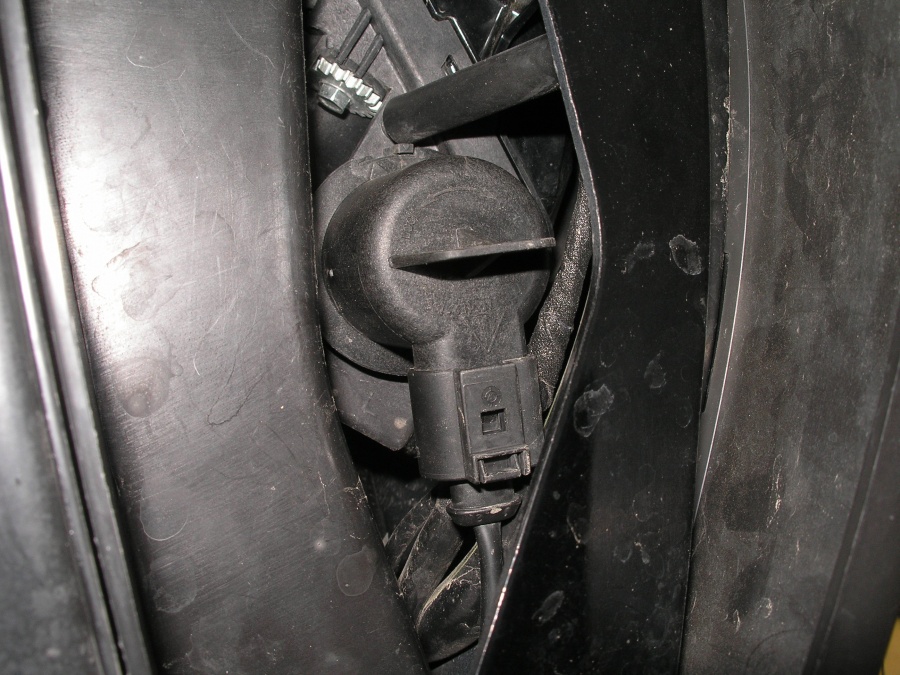

You need to either lift your front end on ramps, or a lift to get to the fogs.
When you lift the car, and take a look under the car, you'll see two black plastic cylendars that are twist locked into place. One on each side. Just unscrew them, disconnect the wiring, and unlock the wire holding mechanism for the H3 bulbs.

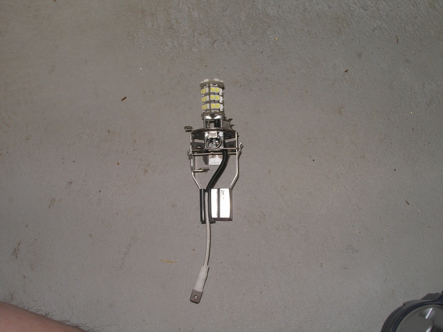

Here are the pics...If you notice the dLED bulb, please note it will NOT fit into the fog lens. It fits in the holder, but has too large a diameter to fit into the projector. I had to send them back to v-leds.com...
You essentially twist off the locking plastic cylinder, pull the electric plugs, and turn to unlock the bulb holder. Hope that helps.

Sorry, confused by your post. The dLED H3's will not fit?

The LED h3 is from vleds, different company. It wont fit and also will trigger a bulb out warning. Its not a dLED from Hoen, those use the Bosch chips that work with the system not triggering a fault.
I tried LEDs from superbrightleds.com in the rear brakes, not only where they less bright they triggered a fault.
I asked the guys at Hoen, no go on dLED fog light, brake light bulbs etc. as they say they cant get the brightness with current leds on the market but this may change as technology improves.
