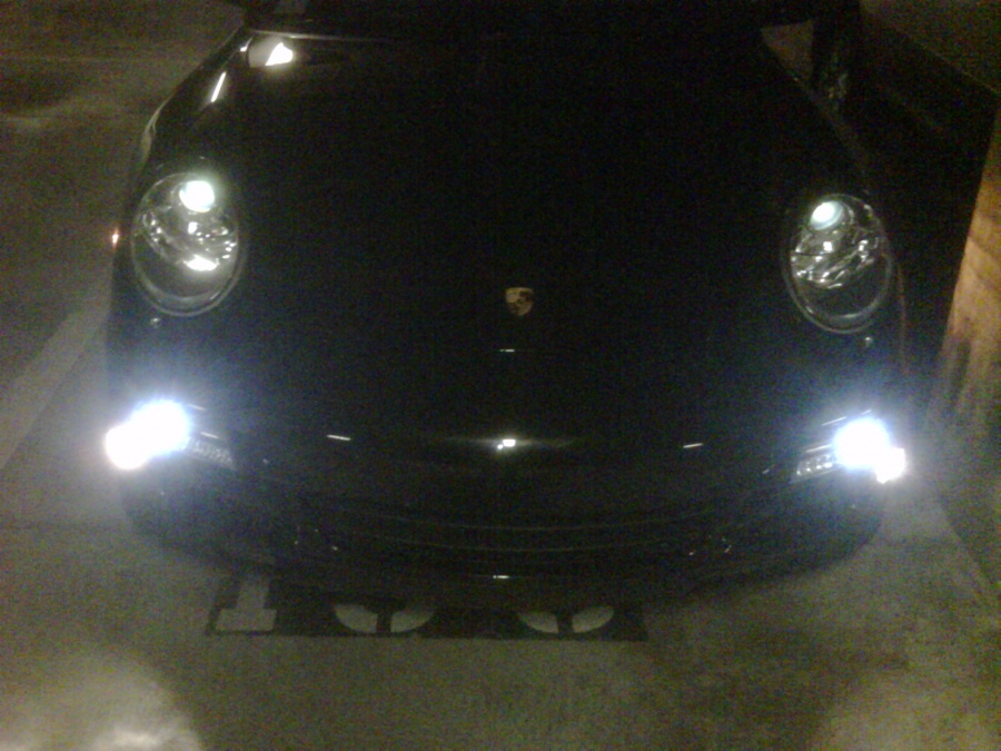

By the urging of gmoney, I went ahead and ordered the dual-axis LED bulbs. I love them! I recommend this product to everyone. It took me 5 minutes to install them in my dark parking lot. While I was at it, I also installed the license plate lights. Here is a bad camera-phone picture of the city lights with the fog lights on. As you can see, the little LEDs totally overpower the fogs now.
Thanks to gmoney again for the advice.
