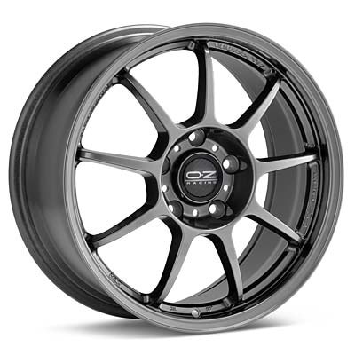

If you don't have PCCB some very economical options for perfect offset 18" wheels are
996tt hollow spokes ~$1k on ebay
997.1 C4 carrera III wheels ~ $1.5k ebay
OZ Alleggerita 18x 8.5/12 $1600 new Tire Rack
I have run both the Carrera III's and 996tt hollows with no issues. Had the OZ's been available a couple of years ago I would have probably bought 3 fronts and 3 rears.
First, I do have PCCB and that limits my choices.
I love the OZ Alleggerita wheels, especially in orange, but it doesn't look they will fit according to the OZ website. I probably should give TireRack a call to verify.

A member use the OZ's as a winter set:
https://www.6speedonline.com/forums/...18-wheels.html
But he has standard brakes. If you are really interested in a track setup, and the 18" is the smartest move, there should be plenty of members willing to: standard brakes + cash = PCCB. For the ultimate braking system, buy the brembo upgrade rotors and pagid pads, and nothing will beat that combo.

we have probably 5 sets of those OZ wheels at the shop currently

Casey, I have spoken to Josh and Mike about doing the stage 3+ upgrade and am near pulling the trigger. I assume when you say you have five sets of OZ whells in the shop, they are for re-sale so maybe we can work them in to a package deal??? I have gotten lot's of good feedback from this forum on my original question about track upgrades and am excited to see the performence improvements.
no we really dont sell wheels... they are for our personal cars when we go to the track(all shod with 888s). Ypu having the work done at TPC? The excellence article is in the april issue... ugh hate having to wait!
