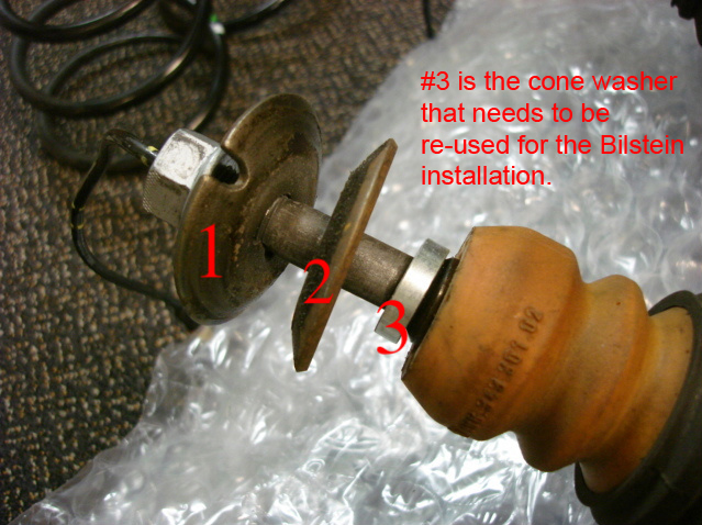

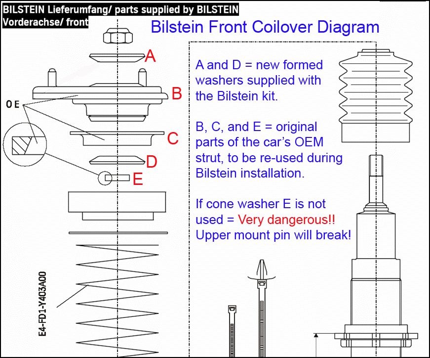

The diagram from Bilstein appears to be wrong with respect to which formed washers are supplied so I made some correction and add some notation. Any dissenting opinion on the accuracy of the 2 pictures? Who knows, this thread might save some lives, or at least some bad headaches.
From the remaining parts, mine appears to be installed correctly. Nevertheless, I intend to print this and hand it to my installer the next time my car has an alignment check.
Please note my pictures and diagrams are not meant to be official; for the official documentation, please check with your installer and Bilstein.
TTdude, thanks but I would hardly consider myself a suspension guru, especially when it comes to installation! Besides the pro's, eclou is the true guru among posters here.

Why does the bilstein diagram in post #114 show four OEM parts whereas the one above show three? Did someone modify the diagram and add the extra line to part A?

diagram #114 is different from the instructions that I got in my Bilstein box and I'm not sure why the change was added...

Hopefully this will clarify. We took some pics today when we installed some Bilsteins in a 997TT. We have pics from the original shock, the new one, the coned washer, the washer installed, etc. We also put a bunch more pics on our Facebook page.
Notice the rubber ring between the Bilstein spacer and the strut mount. Very inportant too. It can wear and cause noise. It is almost always obvious from looking on the outside if it goes bad.

Yes you have to be sure about that OEM washer!!! Other way you will always have problems with the front shocks.

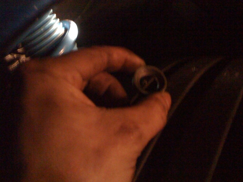

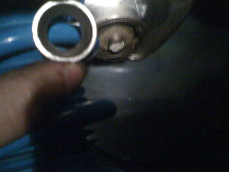

I don't know what to think. I now know the washer was NOT the issue as Bilstein has said (I personally do not believe the pictures I received from them were of my ACTUAL broken shock...I will post comparison pictures in a minute for all you conspiracy theorists out there and let you guys decide). What do you all think? Is it possible these are fake Bilsteins? I've never heard of fakes, has anyone else? What else could be the problem?
