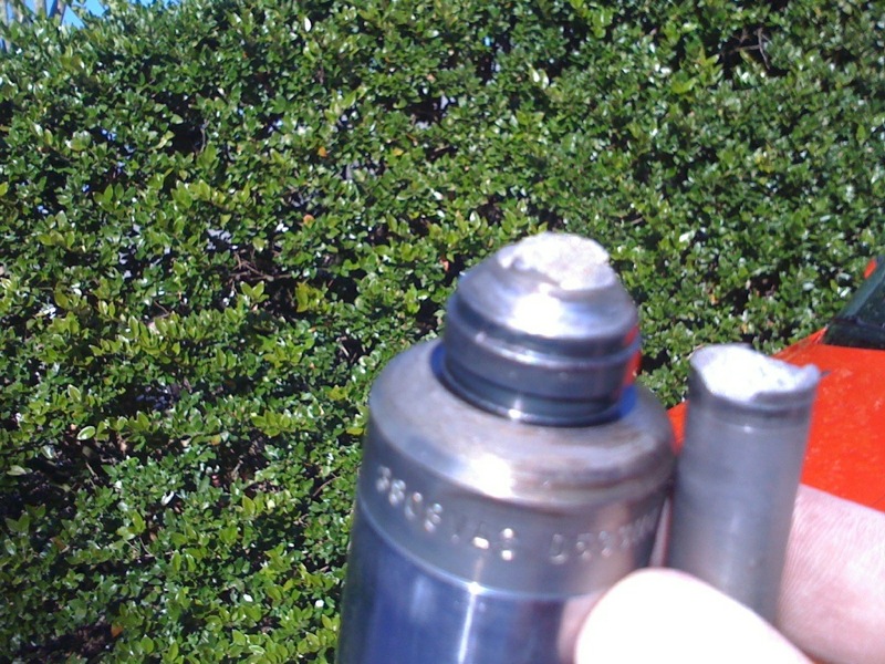

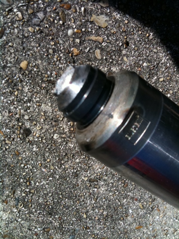

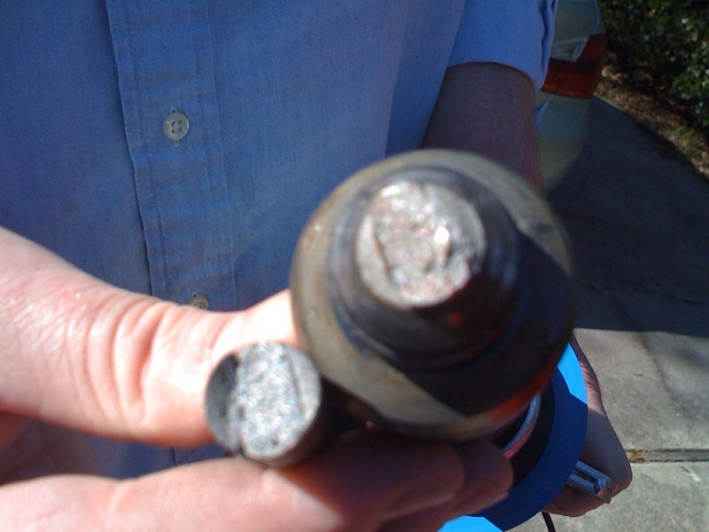

For all you conspiracy theorists...
http://www.awe-tuning.com/media/misc..._statement.pdf
Above is the link thaw AWE provided to me of Bilsteins analysis of my original, passenger side broken coilover. Compare these pics to my attached pics...I will point out some things that do not make sense to me.
1. Notice their picture of my snapped rod (first page, right side picture) compared to my picture #1 and #3; anyone notice the upside down "V" pattern in their pic? Mine has no "V" pattern whatsoever!! It's completely straight!!!
2. Notice their picture of my same snapped rod (first page, left side pic, one with the washer screwed into the bottom) compared to my pic #2...notice their edge looks completely smooth?? Mine is completely jagged!
3. Notice their pic of my "tapered section of mount pin" (first pic, second page) and compare it to my picture #2, #3...the patterns in the metal look nothing alike! I, also, do not see the "flat surface worn into the top" as they describe.
AWE has told me these are, indeed, pictures of my broken shock. What do you guys think?
