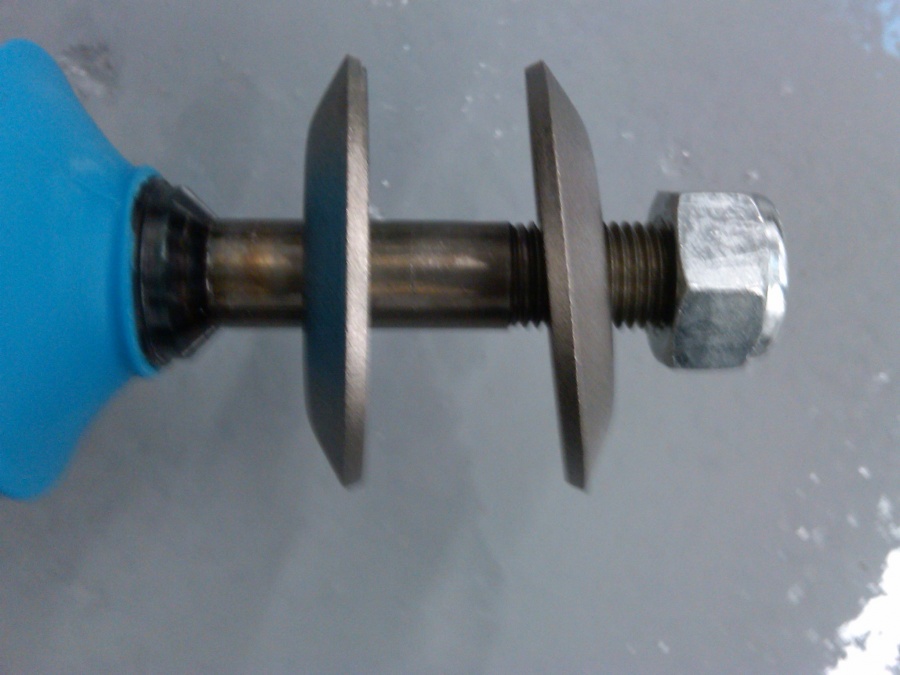

So before dropping off my stocks back to the installer I took a couple of pictures so others can see what you shouldn't get back after the install
If someone can chime in and tell me which #'s SHOULD NOT be there that would be great.
Thanks again!
Thanks again!
This post will explain it all. Please read carefully and look at the diagrams.
https://www.6speedonline.com/forums/...0-post114.html

thanks for the reply Mike. From that diagram it looks like the spacer that should have been taken out is #3, BUT it also seems #1 should have also been taken and transferred over to the bilsteins... Does that seem correct?

Yes, I believe you need all three.

Mike/AWE, C4SxM5, Chris, et al,
It's not that simple. Comparing the 2 diagrams. I assume Washer #1 is A, washer #2 is D, and cone washer #3 is E.
From Bilstein's diagram, washer #2 or D is ***NOT*** OEM. So you are not using both #1 and #2 from the OEM shock, isn't that correct? And if so, which one should you use?

Just took a look at the instructions that came with my Bilstein and item (A) is not listed as an OE part on my instruction. Everything else looks the same comparing the instructions that came with my coilovers and the one posted. Either way, the only thing missing from my install was indeed the spacer (E) on the diagram or (3) in my picture.
I can also see how an installer would miss this item now. The spacer is acutally hidden with the rubber boot on the stock shock and the boot needs to be pull down to be visible.

The Bilstein's come with washer "A" & "D" (see attached pic). I believe we need to use the OEM "C" & "E". I just dropped off my car with Luis at Autodynamica to install the Bilstein's that I bought from AWE a couple of weeks ago & he was aware of this issue. The attached pic shows the hardware that comes with the coilovers. I agree with everyone; dont know why Bilstein dosent include "E" in their kit.

I had my Bilstein's installed about 30 months and 18K miles ago by an company that is well known in the Southern California area for this type of installations and projects that are much more envolved than a coilover installation.
I did not hear any sounds from my supension in the first 20 -30 miles but I did notice that everytime I drove the car and parked it inside my industrial building with a good flat floor I would notice the car would not be at the same ride hieght on the front passenger side. I measured the hieght and then took the car out in the parking lot for a 1/10th of a mile and parked it inside and measured again an the change was almost 3/8" different only on the front passenger side.
I next removed the passenger side coilover myself and found the "E" washer was missing. I found one of the "E" washers with my stock parts and installed it per the Bilstein instructions (included in the coilover box). I next checked the front drivers side and found the "E" washer installed properly. I next checked the rear installation and all was good.
I drove the car about 50 miles over the next week and the ride hieght was no longer changing and so I took my car to have it aligned and conner balanced.
As much as I am disapointed in the company that did a bad installation I will not name this company because I did not call them and give them a chance to fix or make good on their mistake. I was very sure before I removed the passenger front coilover that someting was wrong and I just needed to put an end to the disapointment and fixed it myself. So right or wrong I wiil never do bussiness with them again.
On a good note I was advised to take my car to RSS Stuttgart in Costa Mesa CA and they did an awesome job setting my final ride hieght, alignment and conner balance.

Bilstein provide the lower large disc as the damper rod is a different diameter. The spacer properly locates the top mount. It is intuitive. Any engineer who misses it is either rushing or not experienced.
