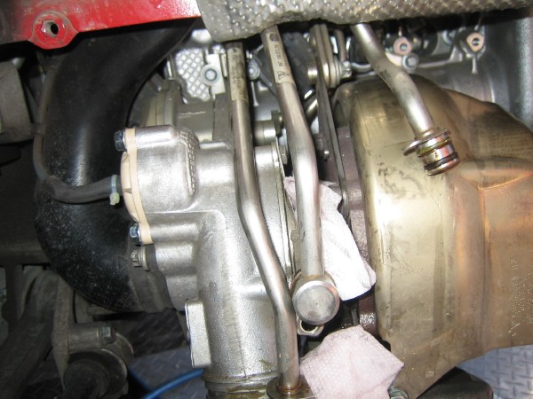

This is not an easy job. Personally, I would not recommend doing this even if you are pretty handy. It is very tedious and requires contorting your hands into some very confining spaces. I lost half a fingernail and the skin off of 2 knuckles. The back of my hands look like I was digging thru barbed wire. You cannot really wear gloves for the intricate work that is involved. You will need male and female torx bits, universal 1/4" and 3/8" adapters, long 3/8" extensions, a long 3/8" wobble extension, ball ended and regular ended allen keys and sockets in 4mm and 5mm, a 10mm and 5/16" combination end wrenches. SpoolnV8 and 997John did this job without removing the turbos, and so that is how I proceeded. After doing it though, I think it may be easier and faster just to remove the turbos. That being said:
1)jack up rear of car and remove wheels. Remove rear wheel liners. Remove tail lamps. Remove rear bumper.
2)remove intercoolers. Bend up the heat shields out of the way.
3)remove heat shield - the following is for the passenger side plugs. The forward torx bolt can be removed with a 5/16" combo wrench working from underneath

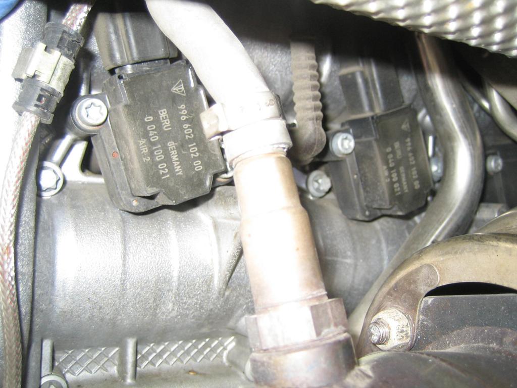

4)coil packs are visible now. Push the rubber boots up to allow the clip to be undone, then you can unbolt the coilpack and remove it. The rear 2 spark plugs can be removed now with long extensions. I used a wobble extension on the spark plug socket.

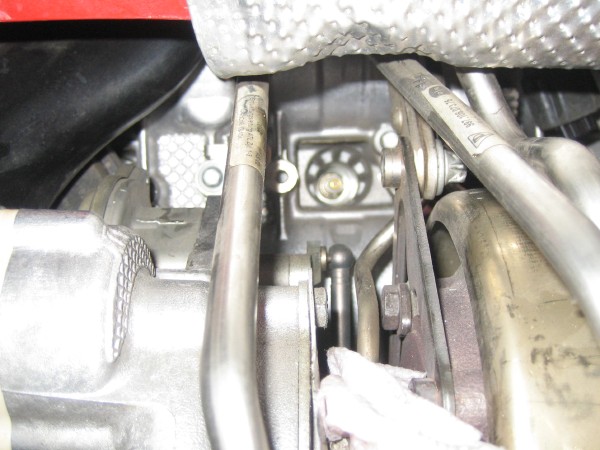

5)the forward plug looks impossible to get to. To R&R without removing the turbo requires - unbolting and moving the 2 oil lines and 2 coolant lines to the turbo. Push these out of the way best you can. You now have to unbolt the 3x 5mm allen bolts holding the VTG controller from the turbo. You can pop-off the actuator arm to ease it some, but this part really sucks. The task requires some real contortion. Try to break the bolts first with a 5mm allen key socket or allen key, then go to the ball ended key. If you can do this, you can probably jerk-off a hamster blindfolded. Loosen the compressor inlet duct to help remove the VTG unit, then you can get to the coilpack and spark plug. Whew!
take a break:
6)the driver's side is no less difficult. The rear plug is relatively easy. The middle one requires the removal of the cooling lines to the turbo and the VTG unit - again, a task only for the "Hamster Whisperer"
7)the forward plug is pretty tricky too. You have to remove the diverter valve then loosen the compressor inlet duct. Removing the diverter give you just enough room to wriggle the coil pack out and to change the plug.

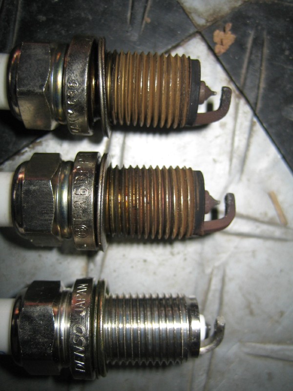

Reading up on the 996tt boards the symptoms seemed to match what others had noticed. Sharky's post on 6speed made me start to wonder if the plugs could be the issue. So, I decided to plunge into the job. I originally was going to go back with the stock Beru/Bosch plugs, but the dealership and local wholesalers did not have them in stock. This pushed me to doing the Denso double platinums in 1 stage colder than stock. These are the PK20PR-P8 plugs which wholesale at less than $6 per plug. Looking at the tips, you notice that the insulator is shorter than stock, and the electrode is a fine tip similar to stock. My old plugs were showing some wear, with about 8mm gap in the plugs. Stock recommendation is about 7mm so there was definitely compromise there.
Happily after this tedious task, the car is running noticeably smoother than before. There is no more surging or hesitation, and my butt dyno thinks the car found a good 20-30hp. I hope that the Densos last another 15k miles or so, because this job made me feel like this guy:
