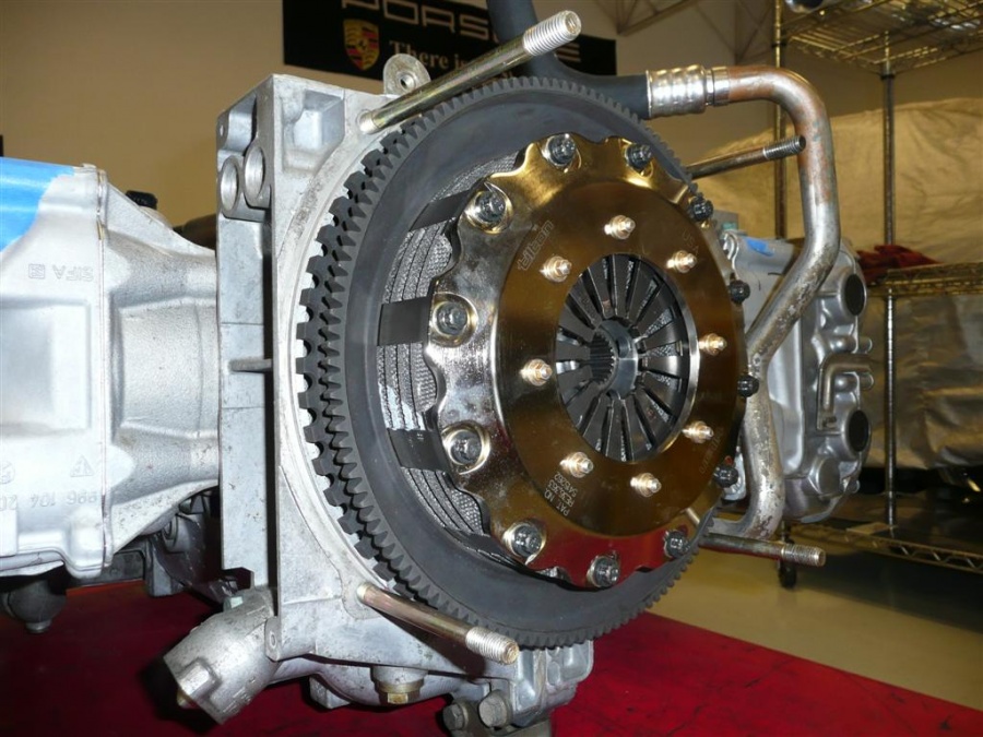

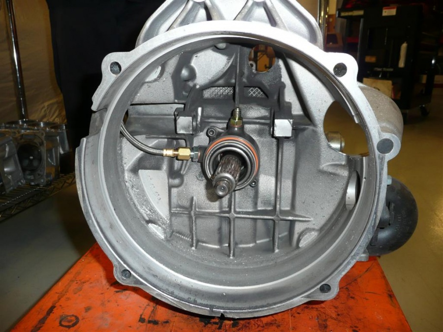

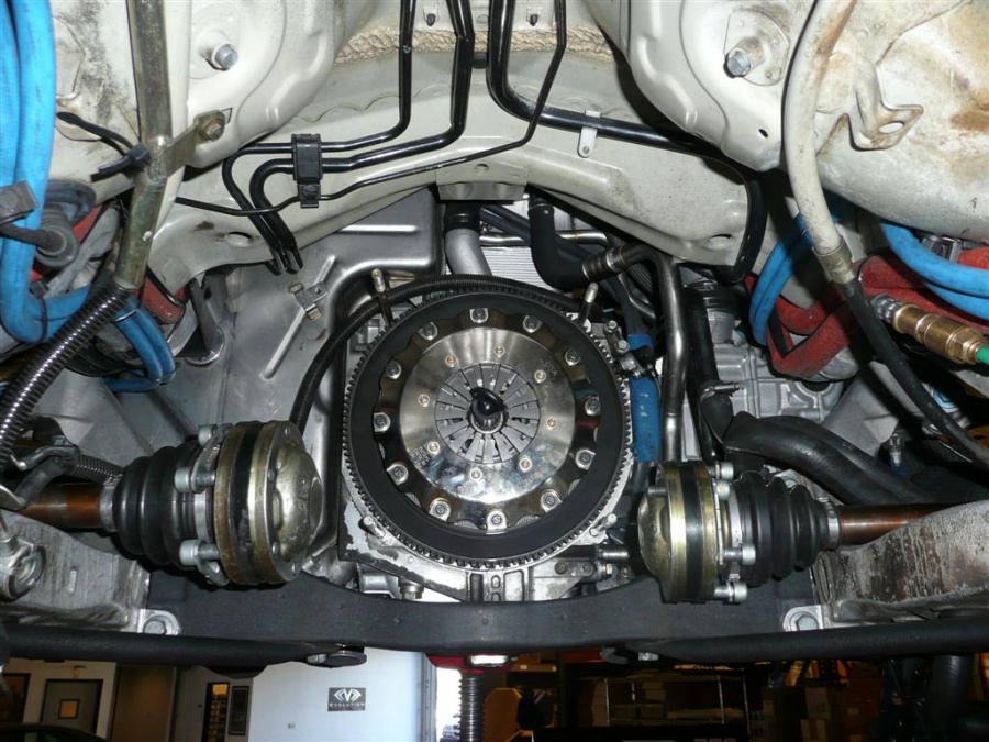

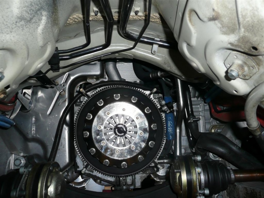

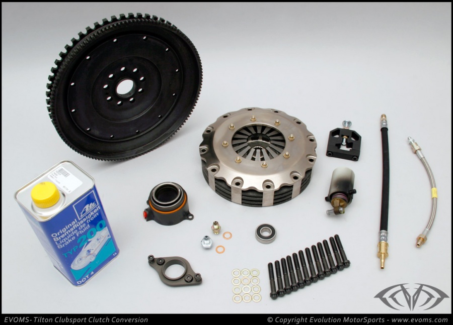

The Tilton setup is fantastic and I am running the same setup in my 997TT. Here are the Pro's and Con's as well as a link to the detailed information about this setup:
Pro's:
Can handle ~ 1700+Nm of TQ
Smooth clutch engagement / modulation
Very lightweight
Proven reliable
Con's:
~10,000 KM service intervals - Can rebuild up to 3 times
Shorter clutch engagement point
Louder transmission noise
More details can be found here: Porsche Tilton Clutch Press Release

The best clutch $$$ can buy.. Your right on target with pros and cons as well.. Some more Pros would be, the Hotter it gets the harder it grabs which is typical of Carbon Clutches.. Also, in a 1/4 mile car 60fts will improve by allowing the clutch to slip as it leaves the line..
