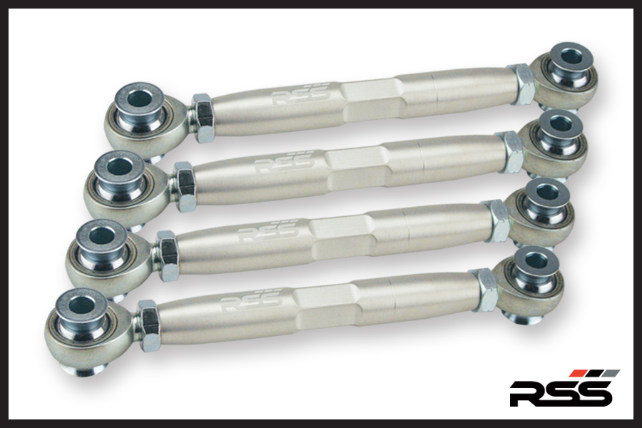

In regards to your question about rear adjustable toe links. The addition of a adjustable rear link kit (dogbones) and/or an adjustable toe steer kit may not be needed with your application. They will give you the ability to have proper toe settings and have more positive camber if needed depending on your overall setup and how low you go.
For instance, since you mention tire wear - an adjustable rear link kit (dogbones) will correct rear suspension geometry of lowered cars which improves handling and feedback. The additional negative camber in the rear can prematurely wear out rear tires as the factory accentric bolts do not offer enough adjustment to properly re-align the car to desired specs.

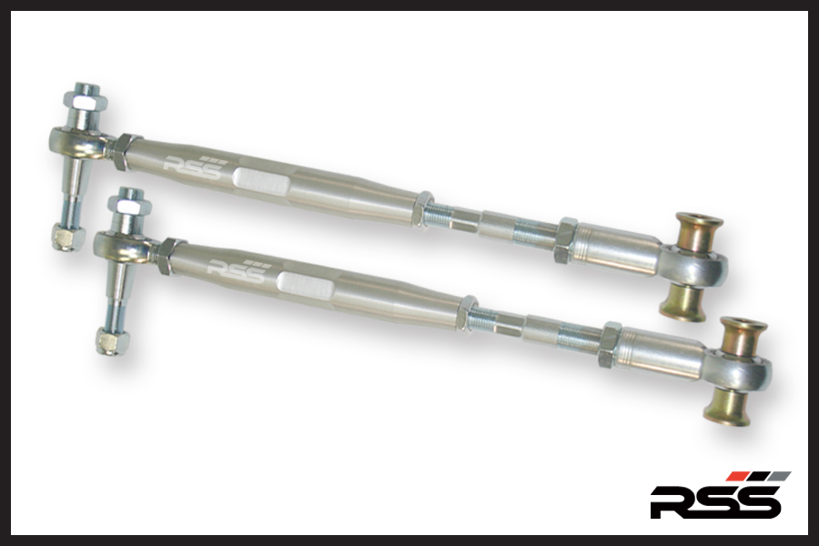

A toe steer kit is also used on lowered vehicles to help minimize the suspension geometry change and allow toe adjustment at the toe steer arm giving the ability to make adjustments independent of the factory eccentric bolts which may not offer sufficient adjustment - depending on your desired setup.

Feel free to contact us directly with any questions you may have. I've also attached pics of the:
(1) Adjustable Rear Link Kit (dogbones)
(2) Adjustable Toe Steer Kit.
