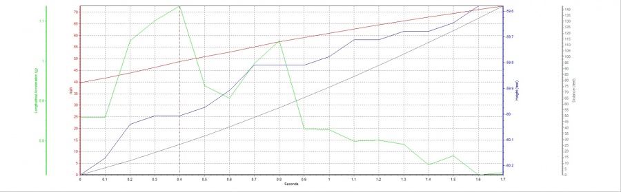

Originally Posted by TTdude
One experiment that might be fun to try is see how everyone's mods pull in 2nd gear from 35-70 mph (in the legal zone for many highways). Pbox it and let the data speak for itself. Better than comparing different dynos.
I did not have a second gear graph showing 35-70. The only one I had was 40-70 mph in 1.52s.
That'll work. Let me see what I have. Thanks for posting.

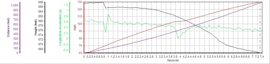

Originally Posted by bbywu
Actually, if you look at previous datalogs for the 997TT, a large number of them run 100-200 km/h in about 6.5 to 7 seconds for a flash + exhaust.
Case in point, look at MadSex343's run...ECU + exhaust:
His 100-200 km/h (62-124 mph) will be somewhere around 6.5 seconds on pump fuel.
So...a 6.3 100-200 km/hr run with a flash only is pretty exceptional.
Actually if I am not mistaking (will have to double check) this exact same run if extracted for 100-200km/h results in 6.1 secs
Will try to get it for you from the entire file if possible...
But you get the picture! By the way I have a run of 7.5 sec with just the exhaust on a completely stock car otherwise and always use your equivalent of 93 oct pump fuel here...
Exactly...
Which is why I think a 6.3 on a flash alone is very very good!
