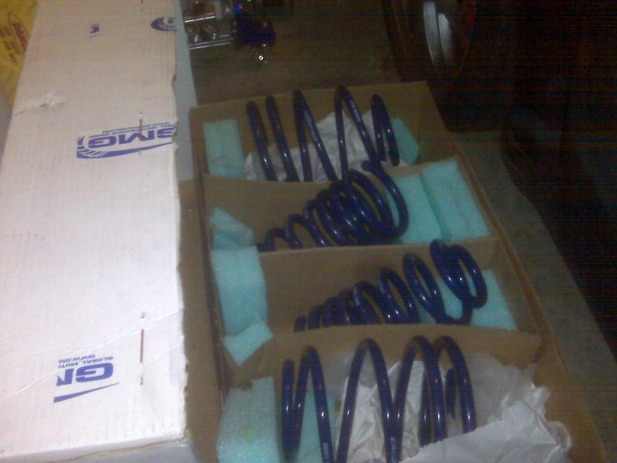

You'll see when you install it, that's the way it picks up the bracket.
BTW, I agree 100% with Neil M, the issue is mating bilsteins to aftermarket sways. I hold that the position they are attached to the bar has a minimal effect. Everybody I know who has an OEM front bar, bilsteins and the dlink mounted inboard, as per the bilstein instructions has yet to pop a link. I have personal knowledge of 4 cars around me with no such issues, all 4 cars see the track regularly. Just sayin....
My solution:
They're baaaaaack!
