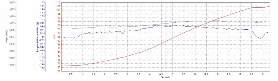

Mid Range Times Comparo
I thought it might be interesting to see how different mods perform in mid-range where most of us drive most of the time. Here are mine (I chose this range so you can see the lag).
Manual, 3rd gear (0 shifts):
30-100 6.70s
40-100 5.12s
50-100 4.10s
60-100 3.38s
70-100 2.62s
80-100 1.90s
90-100 1.02s
91 oct, Ecu/vgts/exhaust upgrade.

Hi Bogg, The numbers are all derived from one run. From the more complete graph below, it appears that I nailed it around 26-27 mph. It's not a precise way to measure boost response but somewhat indicative. By comparing the 10 mph delta one can see where the sweet spot lies for my set-up (at least for 3rd gear). Btw, I've done a 4th gear pull 60-130 on another thread but haven't broken it down like this. I'll do a 2nd gear one as well at some point. Anyhow, my data is posted if anyone wants to compare. Dave
10 mph delta
30-40 1.58s
40-50 1.02s
50-60 0.72s
60-70 0.76s
70-80 0.72s
80-90 0.88s
90-100 1.02s

Loaded up the race file. Couldn't get a 60-130 but managed to squeeze in a 60-80. I'm probably running 1:9 (pump:race fuel). From this data, once I hit around 65 mph the difference starts to show. There was about a 20 deg difference (increase) in outside temp compare to the earlier pump tune.
60-80 mph (3rd gear)
Red: Pump tune (1.48s)
Blue: Race tune (1.33s)
