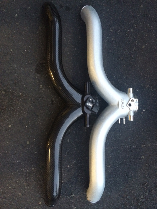

IPD dimpled y pipe

Werks1 cf y pipe weighs exactly 1 lb
But does one make more power than the other?
I never dyno tested them so I couldn't really say. It could have been a placebo effect but it seemed as if the iPD dimpled pipe had stronger midrange for some reason.
The Werks def had greater internal volume.

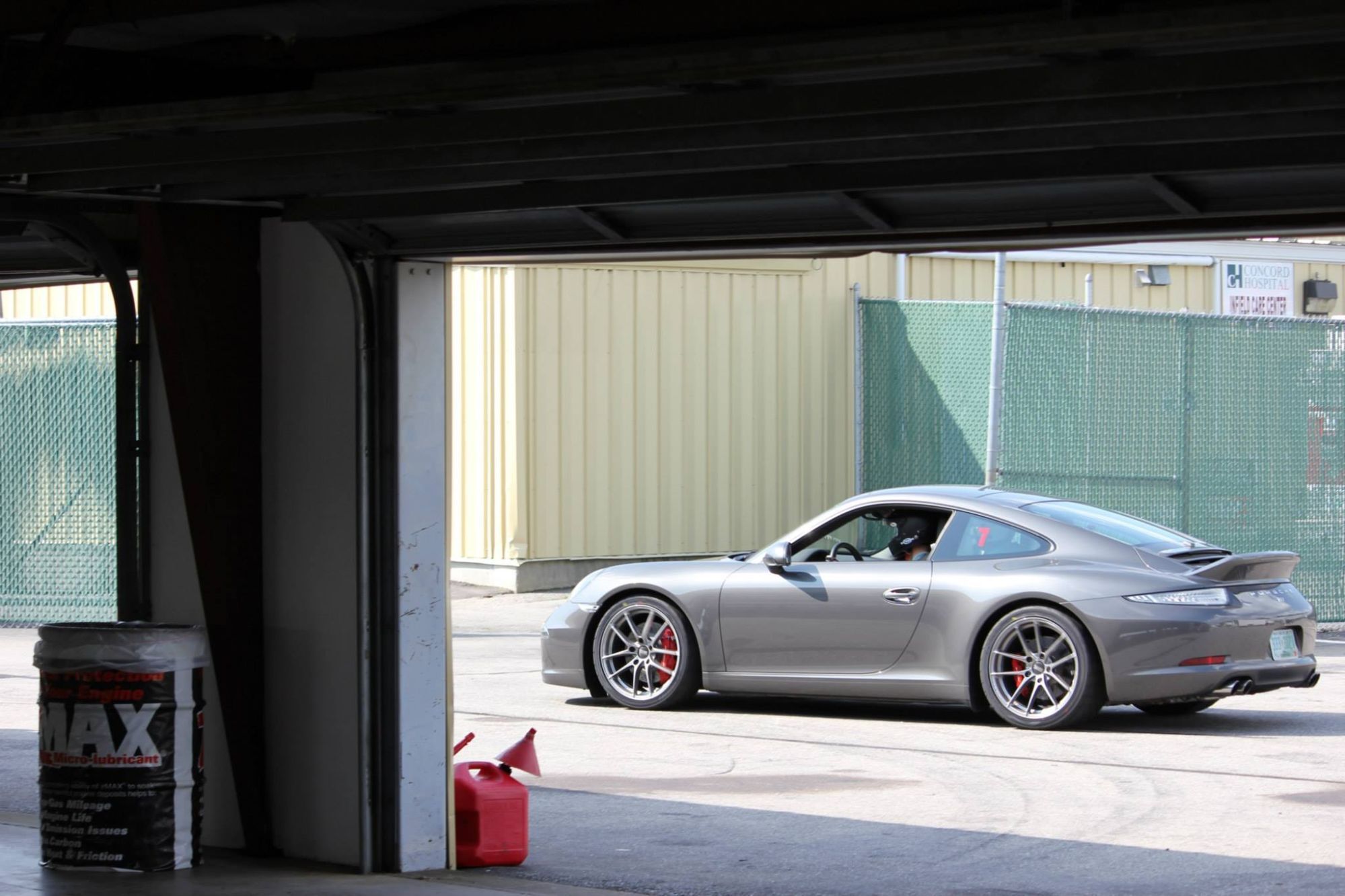

For 19" it looks like the options are Ultraleggera or Formula HLT.
The Challenge 18" is probably lighter but I would like to stick with 19's.
I have the leggera and i'm pretty happy with it. Not my car but it gives you a idea:
