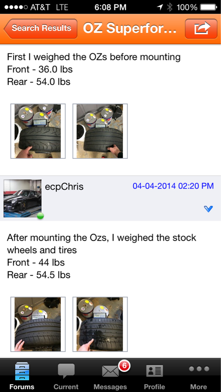

Which OZ wheels? I have weight of our stock wheels in another thread
For 19" it looks like the options are Ultraleggera or Formula HLT.
The Challenge 18" is probably lighter but I would like to stick with 19's.

On my phone so can't post it cleaner but here is a comparison of my OZ to stock

  #90
longboarder's Avatar
Joined: Apr 2013
Posts: 2,439
Rep Power: 272
longboarder Is a GOD !longboarder Is a GOD !longboarder Is a GOD !longboarder Is a GOD !longboarder Is a GOD !longboarder Is a GOD !longboarder Is a GOD !longboarder Is a GOD !longboarder Is a GOD !longboarder Is a GOD !longboarder Is a GOD !
Hmm the rears are about the same interesting. Which OZ's do you have?
