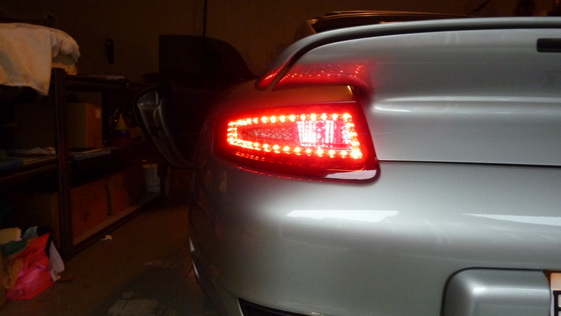

2020: Have you tried having a shop wire a resistor to the turn signal? Sounds like that might resolve the issue.

Does it flash fast or is it just a warning light?

I don't know about the light itself, but the inside indicator does flash fast as compared to stock.

fast flashing of the indicator is a tell tale sign of the car thinking a bulb is out.
The oem bulbs use a 21 through 27w bulb, so you will need a resistor for both brake and signal of similar draw. Without that these lamps will throw a code.
They are marketed as 'error free' so that means they have some sort of resistor in there, clearly not enough however. The trouble with the resistors is that they heat up - a lot - and have been known to melt plastic parts, smoke and cause fire.
Keep an eye on the lamps, maybe remove after a few months of running them and double check for heat related warping for peace of mind.
Like someone mentioned, the error code wont be able to be reset at the dealer and be gone, its there to stay unless enough draw is present.
I think they look a lot better than I expected, shame about the dash light.

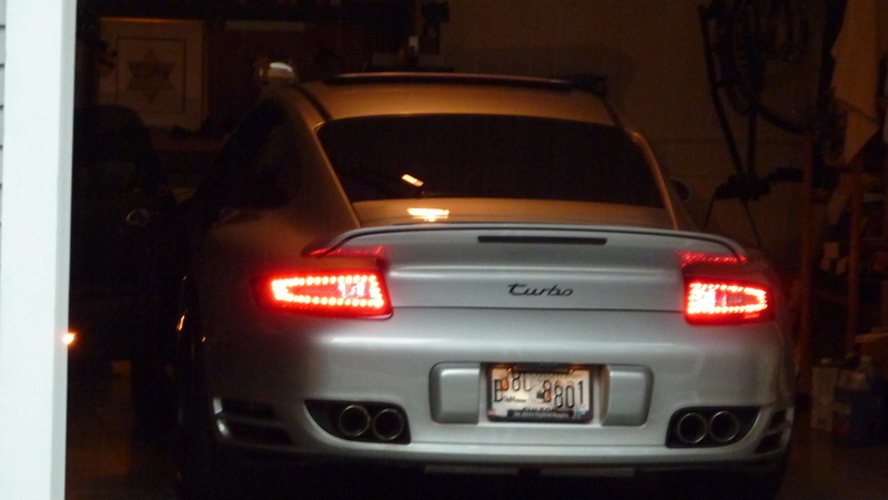

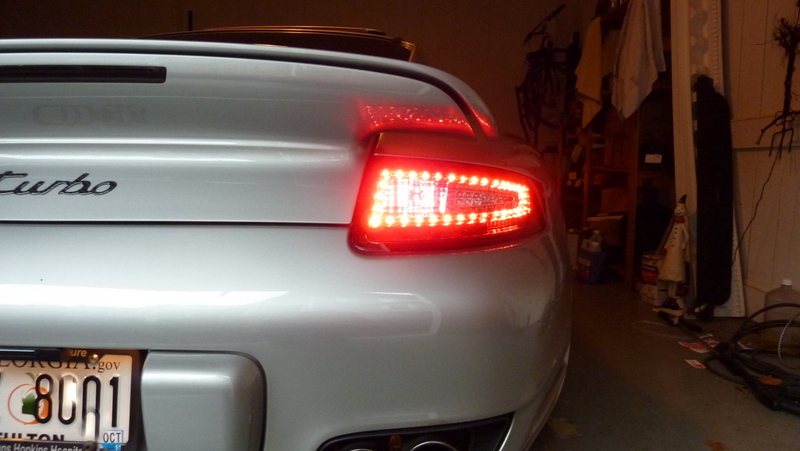

The bling factor of these LEDs are high. Not sure I like the size of the individual lights. Maybe it's just the photo but they seem a little a large for my tastes. Also, the left light seems to have some bulbs not working compared to the right?
The resistor definitely needs to be tweaked up as others have said but I don't like how they jacked up their price $125 all of a sudden. Must be all the inquiries.

I hope adding a different resistor will fix the problem. That's good point to check in a few months for heat damage. The turn signals are amber. On the video it appears that some of the LEDs are not working. This is due to the angle of the camera. All of the LEDs are functioning and very bright. There is no provision for the rear fog light, so that function becomes obsolete (I have never used this anyways). No bodywork modification.
