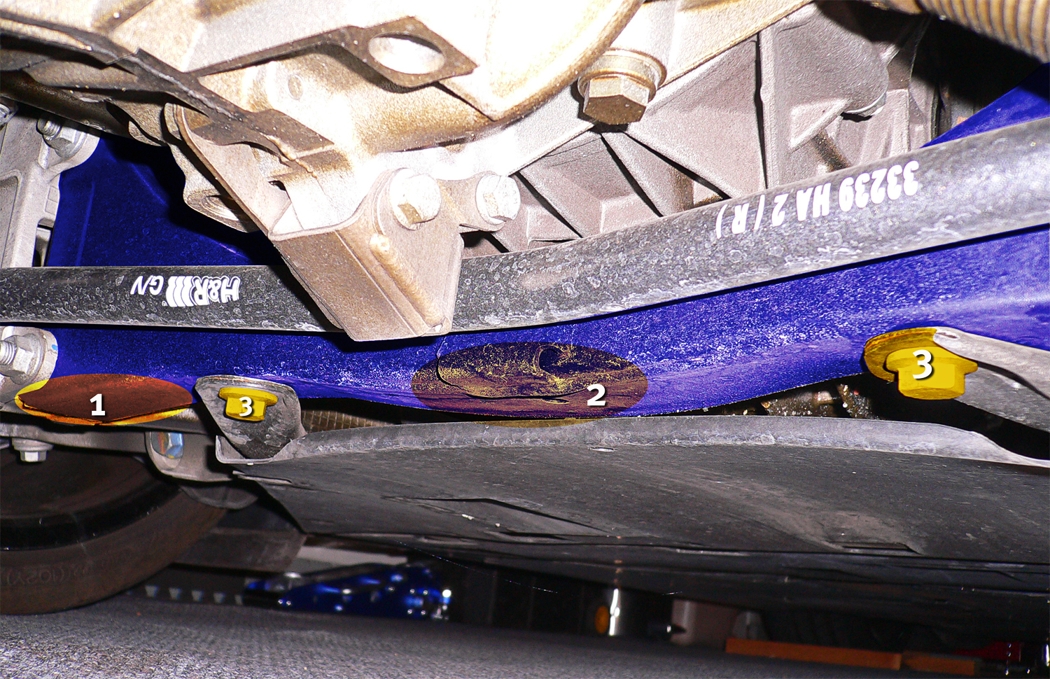

Old Oct 26, 2010 | 04:53 PM
VID997's Avatar
Joined: Mar 2010
Posts: 2,273
From: San Jose, CA
Rep Power: 193
VID997 Is a GOD !VID997 Is a GOD !VID997 Is a GOD !VID997 Is a GOD !VID997 Is a GOD !VID997 Is a GOD !VID997 Is a GOD !VID997 Is a GOD !VID997 Is a GOD !VID997 Is a GOD !VID997 Is a GOD !
Originally Posted by skeeter
Yes sir...I had my car up for a few days doing various things...
Skeeter, when you have a second could you please take a look at the attached photo to confirm the correct jack point. I have illustrated the cross bar (that we have identified in a prior post) in blue and then numbered what looks like could be viable jack points. Which one can I safely use???
Thanks
