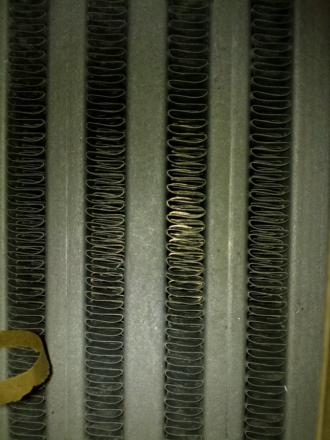

My IC's arrived yesterday!! They look super good, I cannot wait to put them on!!
I have decided, for "R&D" purposes to pass on the meth injection for now, I will do it in a second time. So I will be able to do datalogs and see the IAT behaviour.
BTW, these coolers are made by JDEUS (DENSO) (www.jdeus.com) for Porsche. I bought the IC's from them and not from Porsche directly. This way I have been able to pay a little over 900€ for both.
If someone is interested in knowing the correspondent part numbers I will ask the shop that sourced them for me. Just let me know.
BTW2, these DON'T look cheap at all....we can argue about the plastic tanks, but you can really see high quality in them...
