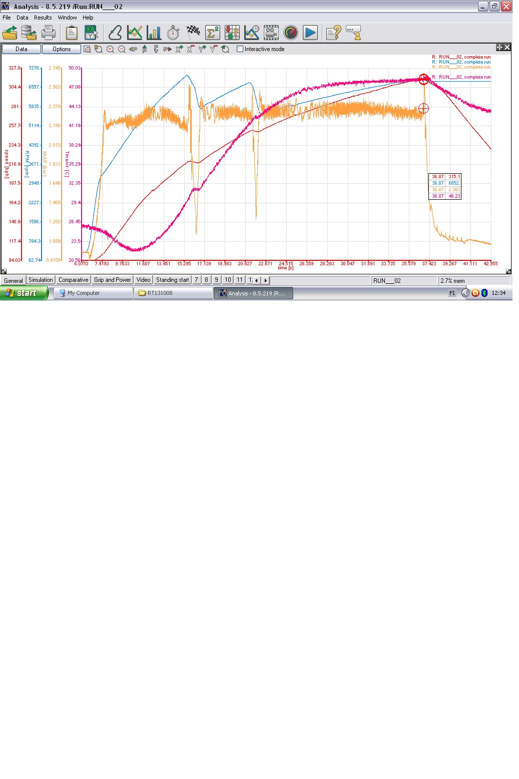

OK, so you have logged some dyno or 0-80 mph pulls...fine. Now show me how these upgraded VGTs or superduperIC really act when installed in a car driven as it was designed.
Example here, includes speed, rpm, boost and intake temperature. Some 30 seconds flat out 4-6th gears, 997.1 VGTs and GT2 RS ICs.

I'm not debating Anything in particular. Not promoting any super duper turbos nor Ics. I'm just saying that I shake my head sometimes when I read some posts. That's all.

In the reply quoted below is an example how differently VTGs (or any turbo'd engine) can be tuned.
Ie one can stuff mismatched compressor/turbine turbos into a car and with tuning tricks plus short dyno runs still quote massive (read: IRL excessive) power gains and fast times in third/fouth gear runs. Or at 1/4 mile... Yet if that combination is pushed to the edge at one mile run the real nature of this system is revealed.
Originally Posted by 996ttalot
Managed to find some time to do a better test of VTGs in terms of impact of 60-130 and 0-300kph etc and the relationship to back pressures/IATs.
In the boost comparison chart you can see the previous boost map - 1.2 bar tailing off to 1 bar in higher load. These are 66mm VTGs but frankly it doesn't matter which VTGs, the concept is the same. We ran the car from 0 miles per hour, shifting at the same time on same stretch of road within 30 minutes of each other. The only change was to the mapping in terms of load etc. The red line takes a different approach - run 1.2 bar and ramp to 1.4 bar at peak.
So what was the results - same set up 60-130mph was over 1 second quicker 6.7 versus 7.95, logical of course - you make more power to run faster times. But, here is the consequence, higher IATs. Car runs GT2RS intercoolers btw. So over 160kph (100mph) you can see the impact as soon as you get into 3rd gear the backpressure builds and rising IATs. These get incrementally greater the faster you go.
If you ran 1.5-1.6 bar the situation will be worse - quicker 60-130mph but press on and afterwards you are going to have the DME cooling the car down, chucking in fuel and retardation.
Unfortunately this test was stopped too early (at 80 mph / 130 kmh), I also would have liked to see what would have above 250 kmh (155 mph) with this turbo/IC combination. According to my own experience the IAT (with GT2 RS ICs) starts to stabilize after that with increasing airflow through the ICs. See the graph above. Total deltaT was 27C and IAT stayed well below Ign pull threshold (55C / 131F).
That airflow just can't be duplicated in chassis dyno runs, unless you perform it in a windtunnel... Engine dyno is a different animal, there you can simulate that flow increase with controlling air-to-water ICs' water temperature.
