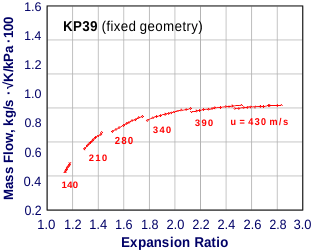

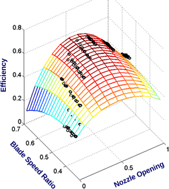

One very interesting test would be this:
-remove one of the EGT sensors
-attach there a pipe (40-50 cm) + about a one meter of temperature-resistant hose + a pressure sensor that's good up to 4 bar ( 1 bar ambient + 3 bat overpressure)
-go and floor it with datalogs...
That would answer all possible backpressure questions.
Someone really interested in finding out things would do a permanent isntallation of (back)pressure sensor, it just needs some exhaust manifold drilling and welding.
Independent of turbine model ( conventional or with adjustable guide vanes) at a certain point it is not capable of flowing more and then the backpressure will increase. Period. With increasing EGT. Period. I'm really astonished if any reputable tuner hasn't done this logging yet!?
Now it's true that VGT's turbines are more flexible that conventional turbo's but they're really efficient only at 60% guide vane opening. Above and under that effiency drops, flow's more restricted.
I'm pretty sure that Porsche has spec'd their turbos to this optimal area. I've only seen partial maps of .7.1 VGTs' programming, but in those screencaptures opening percentages have been in that very area.
In addition turbine flow calculations are a bit more difficult than compressors', one needs to now a bunch of variables to get reliable results. To make things even more difficult Borg Warner has not released (almost) any data about BV50's used in Porsches. Smaller BV40's for certain mid-size diesels are slightly better covered. Big lines can be found there.
Comparison of Fixed Geometry (BorgWarner KP39) and Variable Geometry (BorgWarner BV40) Mass Flow vs. Pressure Ratio:
Effect of variable geometry turbine nozzle opening and blade speed ratio on turbine efficiency:
Source for above data: https://www.dieselnet.com/tech/air_turbo_vgt.php

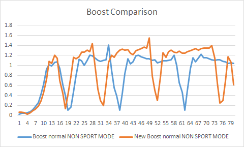

Managed to find some time to do a better test of VTGs in terms of impact of 60-130 and 0-300kph etc and the relationship to back pressures/IATs.
In the boost comparison chart you can see the previous boost map - 1.2 bar tailing off to 1 bar in higher load. These are 66mm VTGs but frankly it doesn't matter which VTGs, the concept is the same. We ran the car from 0 miles per hour, shifting at the same time on same stretch of road within 30 minutes of each other. The only change was to the mapping in terms of load etc. The red line takes a different approach - run 1.2 bar and ramp to 1.4 bar at peak.
So what was the results - same set up 60-130mph was over 1 second quicker 6.7 versus 7.95, logical of course - you make more power to run faster times. But, here is the consequence, higher IATs. Car runs GT2RS intercoolers btw. So over 160kph (100mph) you can see the impact as soon as you get into 3rd gear the backpressure builds and rising IATs. These get incrementally greater the faster you go.
If you ran 1.5-1.6 bar the situation will be worse - quicker 60-130mph but press on and afterwards you are going to have the DME cooling the car down, chucking in fuel and retardation.
