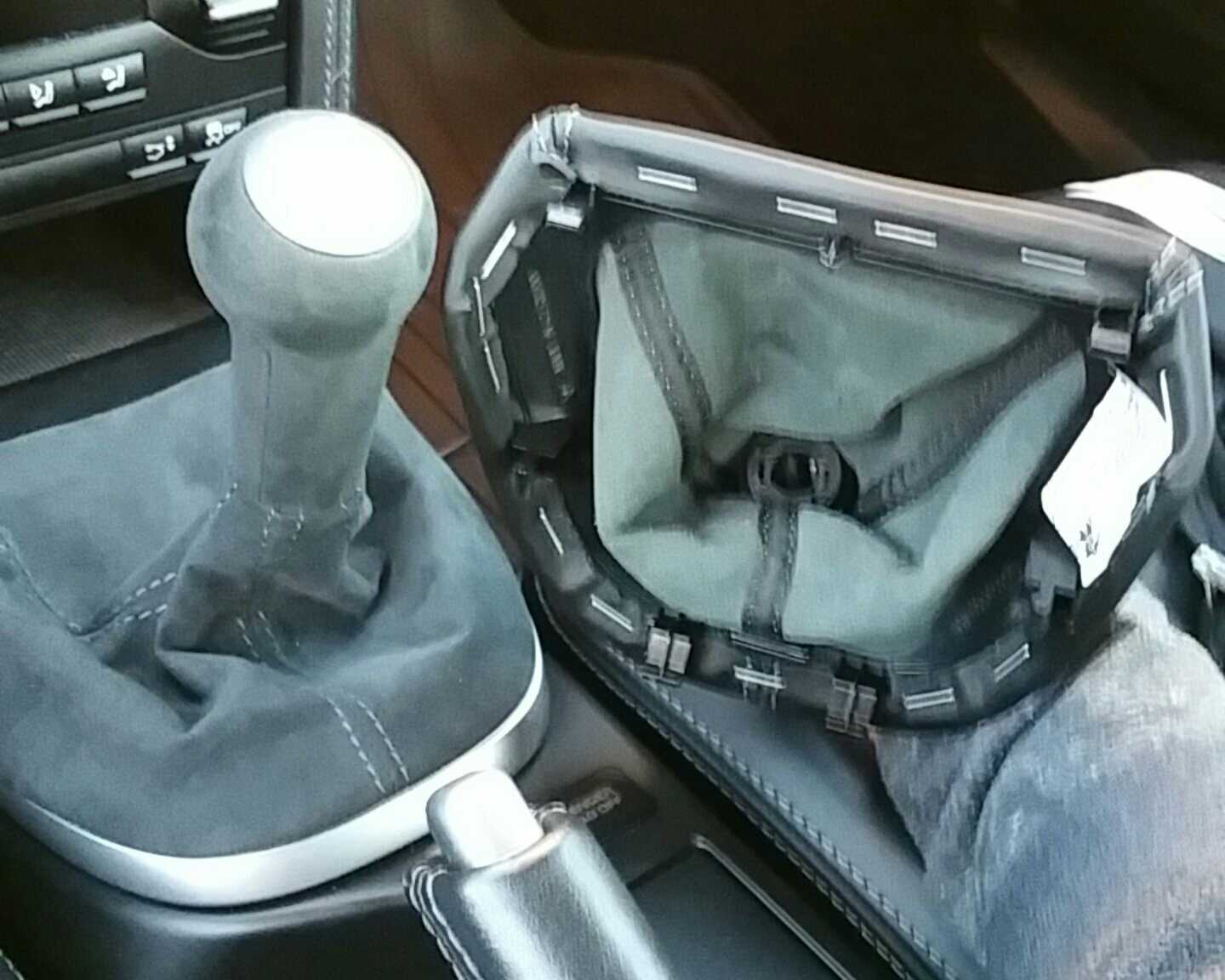

I must be incompetent but I can't even release the shift boot. Is there a trick to "pinch and lift" in the first photo? I've tried pulling, levering with spatulas, etc. to no avail.
Old Mar 17, 2014 | 09:21 PM
  #41
bbywu's Avatar
Posts: 10,774
From: OR Room 5
Rep Power: 1007
It takes some force. The shift boot frame that faces PCM attaches to the console using plastic tabs in speed clips. It takes some force, but pull straight up. Pinching it will give you better grasp. Then give it a forceful pull upward.

I thank the OP for empowering me with the knowledge that enabled me to attempt and successfully exchange a recently changed shift **** from leather to the gt3 alcantara shift **** kit. Since my car is full leather, I feEl it might look better to keep the lower sleeve part leather and the **** part alcantara. Here's the pictures before/after...
Original in leather
Swaped all alcantara
Inspecting bottom shows location of snap hinges
GT3 Alcantara Shift ****/Base view 2
Swapped for leather sleeve keeping alcantara ****
