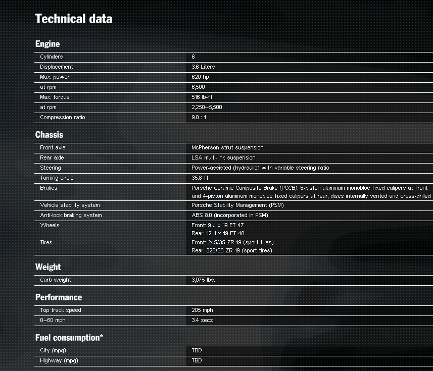

Originally Posted by Tom@Champion
We had one on the lift here for a little while and the turbochargers are different. Our initial impression is that they're the VTG's off the .2 turbo, or very similar in size. We didn't have enough time with the car to really "explore"
Correct on that one.
Don't quote me on this one, but I *think* the intake manifolds are different too. Again, not sure...
997 GT2 and 997 GT2 RS have compression 9.0
http://press.porsche.com/news/pdf/2008_GT2_Specs.pdf
http://photos.stuttcars.info/upload/...GT2RS-1001.pdf
