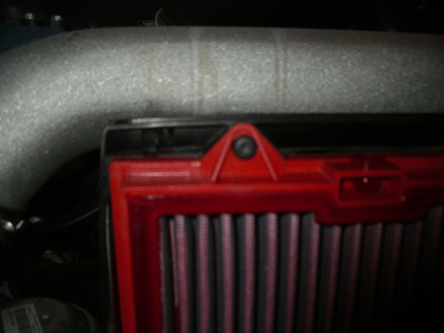

Thanks so much for info and the pics! Glad its that easy, will replace with BMC filter tomorrow. Did you notice any difference once you installed your filter?

Thanks for all the info guys, going to put BMC filter in tomorrow!

just installed it. Has to be the easiest thing I have ever done on a car.
