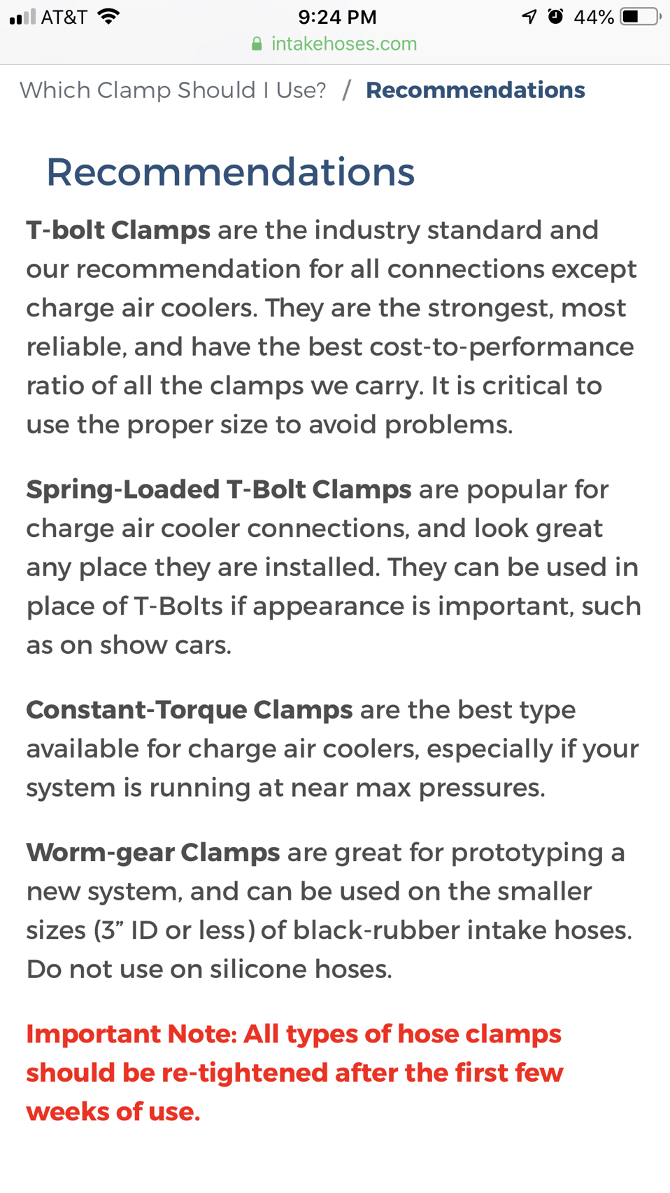

Learned something tonight...
These clamps all need to be of the constant torque variety...ask me how I know.
Please only use: parts number: TS-HCT-M100 available at summit racing or Trident Marine part numbers TSS 56S30 EP and TSS 60S30 EP available at Amazon.
Honestly...IPD should supply these with purchase. It changes your car from "tuner" aka always has an issue to a greater degree of OEM reliability.
