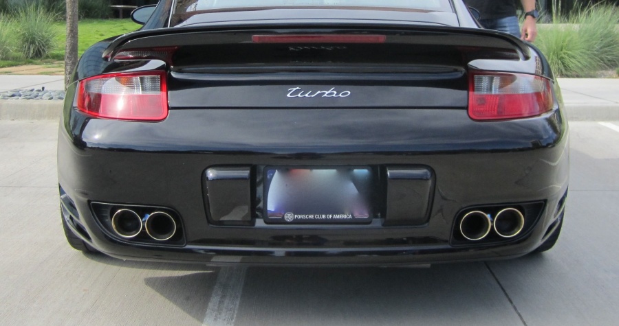

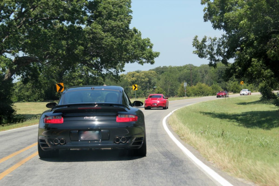

moz - here are a few pics with the 15mm hub centric rear spacers installed
Old Nov 29, 2011 | 07:48 PM
mozhacker's Avatar
Joined: Mar 2004
Posts: 275
Rep Power: 34
mozhacker is infamous around these parts
+1
thks!
(love your license plate too, go PCA!)
