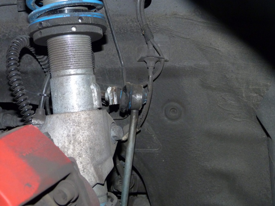

Hello all
last night when I was backing my car out of the driveway I heard a loud cracking sound like something broke or snapped. I was too afraid to drive my car so I jacked it up and this is what I found!Name:  P1020724.jpg
What you are looking at is my left front wheel looking straight into the wheel well. And as you can see, the part of the droplink that attaches to the coilover is dangling freely. The metal that connects the droplink to the coilover has been completely ripped off!Name:  P1020727.jpg
I've posted a similar thread on the 997 forum but then I realized that there isn't as much experience with the non turbo owners. I also remembered drkbrent's experience and had found his thread to be very informative so I've decided to post here. My biggest concern is whether or not Bilstein will honor the warranty. I've had them on my car for 18 months and had a very experienced shop (who I believe have installed Bilstein on many other fellow 6 speeders here in SoCal) install them.
So really one of my questions is what do I do now??

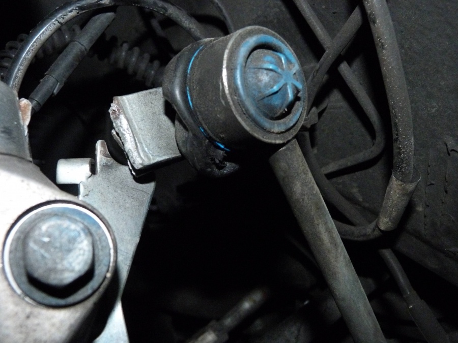

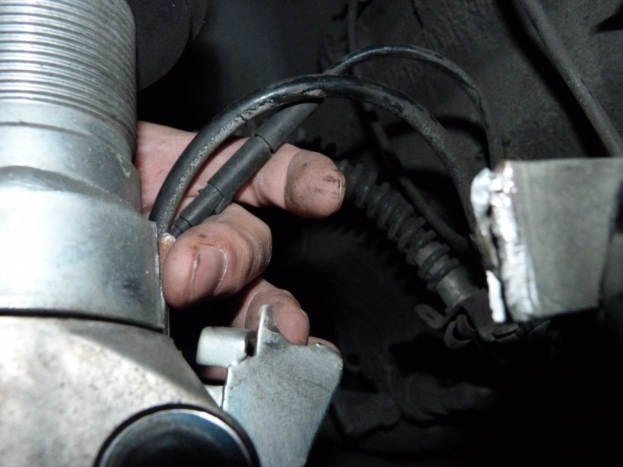

what you are seeing here is where the droplink used to attach to the coilover. My finger is over where the "metal tab" used to attach to the coilover and as you can see it was ripped off.

My Buddha, did you run into a hippopotamus or something? I've never run across anything like this.
Probably a good idea just to flat bed car to tuner, then call Bilstein California help line Monday morning. Have receipt ready and be ready to email or fax it to them. They are helpful & quick with warranty claim if you are original owner. Hope you bought yours new from authorized dealer? Good luck!

If it's broken like your pic, do not drive the car, more damage will ensue.

Don't drive the car - besides the fact that it's broken, *why* is it broken?
Text Tom the picture this morning (PM me if you don't have his cell), see what he has to say. Then call Bilstein.
