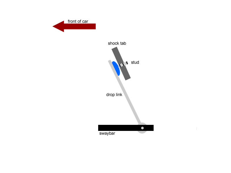

this is a response from Wes Welch (Poway) who consulted with Lou Laurenza
this is actually a picture of the LEFT side so the only difference would be the position of the droplink on the sway bar.
"The upper nut should be facing rearward and the lower nut inboard.
If this is a depiction of the right side (passenger) looking outboard, then it is correct. It lacks a third (Z) axis point of reference."
this is actually a picture of the LEFT side so the only difference would be the position of the droplink on the sway bar. According to Lou Laurenza, the blue ball should be closest to the front of the car as well as the to the outboard side. I am having my drops reinstalled today and will post pics
DK

just got back from having the droplinks reinstalled. this is the left side front coilover and this is the recommended installation by Bilstein. I'll take additional pics if anyone finds it necessary. I mostly drove on the freeway so I can't do a full review. However, with the droplinks in the correct position, I've noticed that all the clunks that have plagued my car for the last 2 years seem to be gone. Hope this helps fellow 6speeders.
I'd like to thank Wes Welch and Scott MacDonald from Bilstein in helping to trouble shoot the situation as well as drkbrent for putting me in touch with them. My faith in Bilstein is now fully restored.

let's just put it this way. IMO, Bilstein was not responsible for choosing the installer and that turned out to be the root cause. Incorrect droplink install, which BTW, I have seen every possible combination on various threads was the culprit. I was always told by the installer that coilovers were inherently noisy, not true! I'm talking about sounds like the suspension is ready to explode when exiting the driveway and I accepted this as dogma.
Now that the car has the links on correctly, the car is once again quiet and I'm satisfied. I think that the problem at Bilstein may be a single woman individual who does not take warranty work and customer service seriously. The techs that I spoke to and Scott were very helpful. I'd buy another Bilstein product but I'd choose the installer more carefully. JMHO

Glad you are happy ,but please , please take care of the PASM wire that is so loos and simply in the wrong place.This wire is the most fragile part of coilover and I believe you don't wont anything to happen to it.
If you don't wont to have any clanks noises ,make sure your coilover is preloud before installation.Many people set them way to low loosing completely preloud of coilover.
