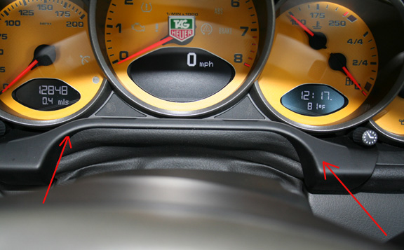

As I've done the procedure before, here are a few things to note:
1. It can be very tough pulling out the plastic trim pictured here. I recommend covering the steering column and the leather dash with blue painters tape to prevent scratching.
2. To pull out the speedometer itself, it can be very difficult as the speedclips on the back are pretty tight. If you use a pry bar, you will scratch the leather. I recommend using these:
And applying them to the gauge face to pull the instrument cluster back.

Thanks, very nice of you to post that. Interesting that it only refers to the earlier models and not the turbo. I fully expect it is the same issue though. While the DIY seems pretty straightforward, I will be to let a dealer take car of it. I trust they will be able to pull it and add some tape!
