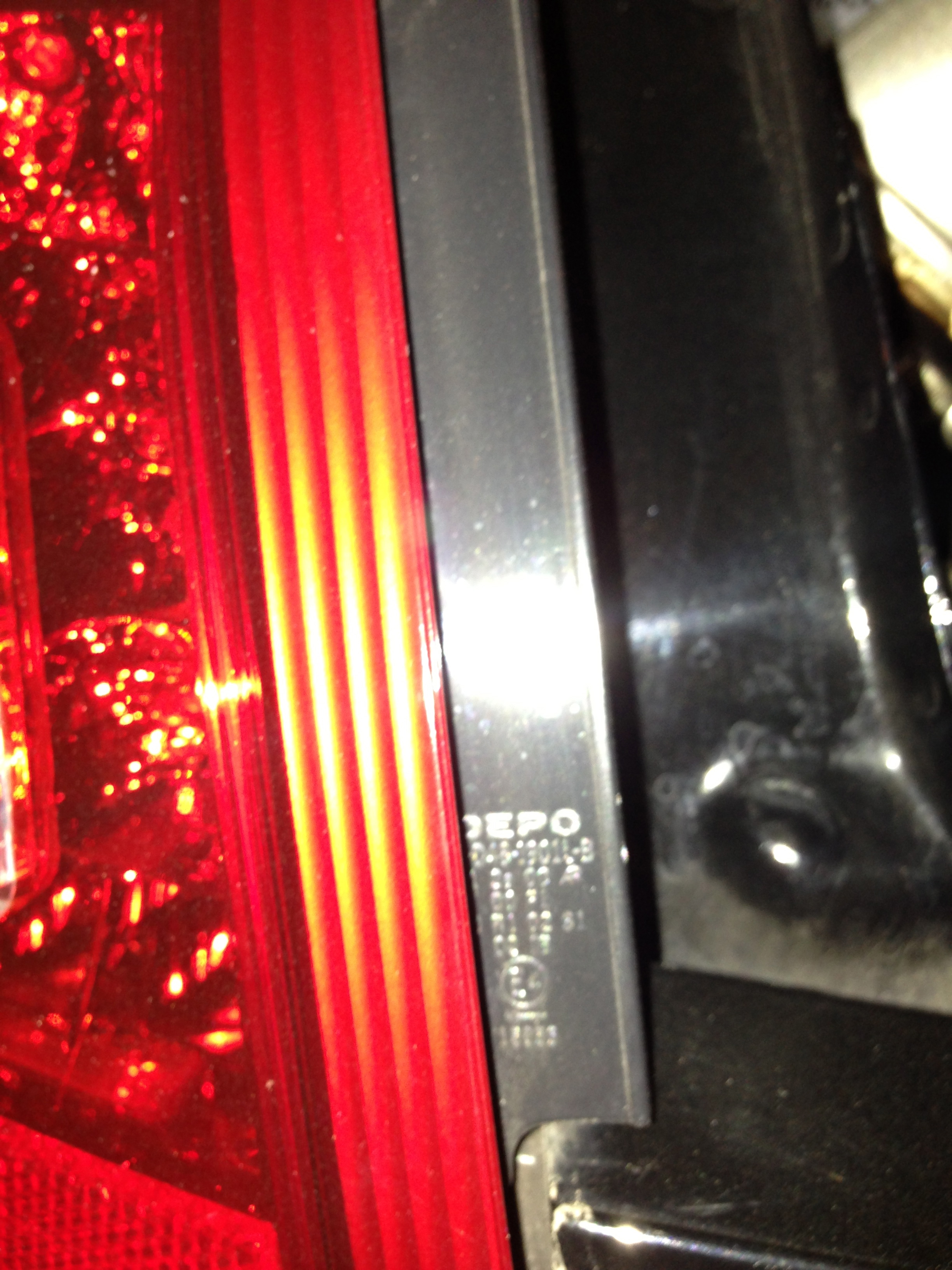

Well...Dectane may be the 'inventor" but I know that Dectane does not "produce" the taillights. They are produced (manufactured) by Depo. Which begs the question about pricing since it looks like CarLightPro is a distributor just like Dectane so Dectane is the so-called middleman here. Manufacturer (Depo) makes a profit on the sale to Dectane; Distributor (Dectane) makes a profit on sale to CarLightPro; and another distributor (CarLightPro) makes a profit on sale to me. Now having said this you need to know that I am a CarLightPro customer. I bought my LED taillights from them in May, 2011 and have never had a problem. I was willing to pay their inflated price in order to deal with a domestic distributor in the event of any problems.
BTW, you can tell if you have "genuine" Depo lights since the name is stamped in the plastic around the interior edge of the lights.
Sorry jhbrennan, but this is not true. The counterfeits have the Depo stamp as well (like every faux Louis Vuitton bag has the LV mark on it). As I did say, the lights are manufactured by Depo FOR Dectane, so they are the Dectane product, like Apple products are build by Foxconn in China, but they are Apple computers, phones etc..
Regards,
Sascha CarLightPro
Regards,
Sascha CarLightPro
That's why I put "genuine" in quotes. I bought my lights from you - they are marked as Depo lights and you buy from Dectane. As you've said, others (like FVD) sell Depo lights (maybe unauthorized). Since FVD is a German company maybe they also have a Dectane source and then provide the lights to FVD US to sell to US customers so who's to say their Depo's are counterfeit?
