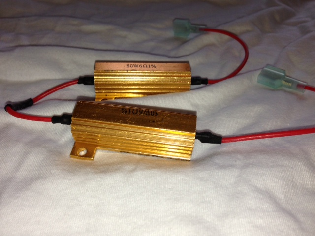

Resistors in series arrangement
Take two of the 6ohm 50W resistors & connect them in series like the photo.
I'm no good at soldering so you can use wire connectors if you want, I'm also a bit lazy so I got my resistors from Shane at DelRey Customs. Thanks Shane! Connect the T-tab connectors onto the ends of each resistor. Once done meter your resistor arrangement to check if your connections okay. 6ohm + 6 ohm = 12 ohm on your meter.

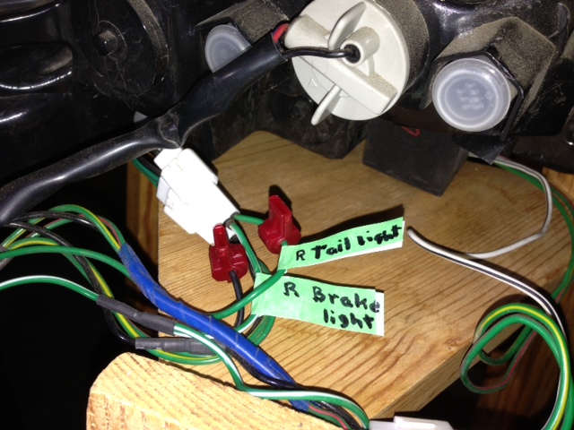

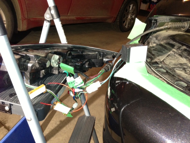

Thumbs up This is an overview photo of what the fix will look like

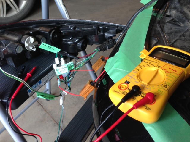

What I did was first turn my light on (had the battery charger connected on too!)
I used my meter & checked the funtion of each wire. On the Dectane arrangement. The Black wire is ground.
I used some masking tape to make small labels for the wires & their specific function on the light. For instance & a photo will show this, a solid green wire is for the tail light power.

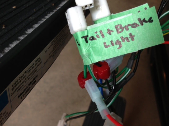

Cool The tail light indicated by the warning light has to be ON
When you turn on your lights & start metering, you need to have the tail light illuminated to detect signal on the meter. This requires you to turn the lights ON & OFF a few times because it's unlikely that you will be fast enough to meter the right wires before the light indicated by the code to goes out.
Hint: Look closely at my photos which are labelled & just make sure your lights have the same wire powering the tail light. It's green on my set, you just have to check your set with the meter to MAKE SURE you have the right wire marked.
YOU HAVE TO FIND THE POWER WIRE CONNECTED TO THE LIGHT INDICATED BY THE ERROR CODE For mine it was check L tail light, so that's the wire I was looking for.

Originally Posted by G-forceTarga4S
When you turn on your lights & start metering, you need to have the tail light illuminated to detect signal on the meter. This requires you to turn the lights ON & OFF a few times because it's unlikely that you will be fast enough to meter the right wires fast enough before the light indicated by the code to go out.
If you look closely on the photo you will see 3 wires going into the unit. The two wires which have RED T-tab connectors on them are the ones you need to mark. The wire with the white stripe is for the brake light & you don't touch this one. The SOLID GREEN WIRE is the tail light power wire.

Lightbulb Now turn off your lights!!!
Now that you have the correct wire identified, separate the white plug, so you will have better access for splicing in your T-tabs
Put one on the BLACK wire & one on the GREEN wire
After you have done this connect up your IN Series Resistors to the T-tabs on the wires. Just make sure you push them in hard enough to ensure a good connection.

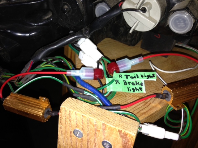

Wiring in the resistors
Your arrangement should look something like this.

Before you think of putting anything back together, you need to test your fix
Once the resistors are connected in place, turn off ignition, then on & turn on your lights.
Wait for atleast 10 min to see if an error code appears. If you have done everything right & you did the specific side indicated by the warning light, you have fixed the problem because even after a long while the light will remain on. That is why I had my battery charger going as well.
