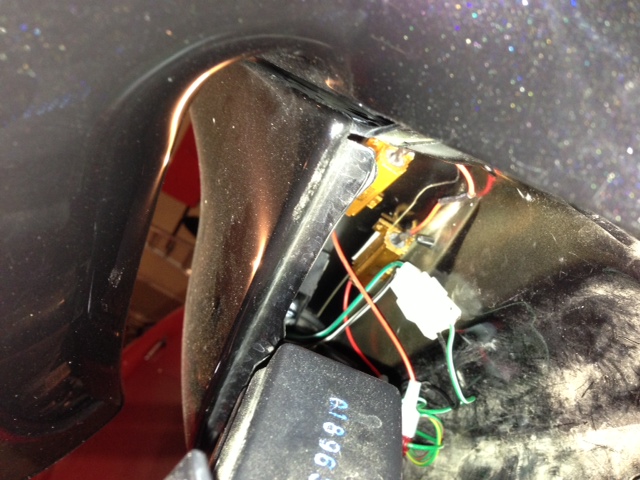

Stick them in there something like this
You have to look at the light housing & then think about the best fit inside the enclosure with all the wires. Putting the resistors on the back & more towards the middle of the car works well.

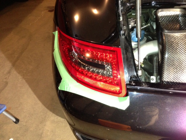

Thumbs up Now put everything back together
Now carefully put the light back into it's enclosure on the car.
Notice I used masking tape to protect my paint.
Ensure the mounting bracket on the light catches the front car mount.
Before you tighten everything up with your T25 Torx & recheck your light again to make sure you didn't pull or disconnect a wire. Then you are finished
If you have another coffee you can move on & do the other side as well.
On my car I remember getting the right light warning light a few times, so I fixed both sides. NOW NO MORE WARNING LIGHTS FOR MY CAR
