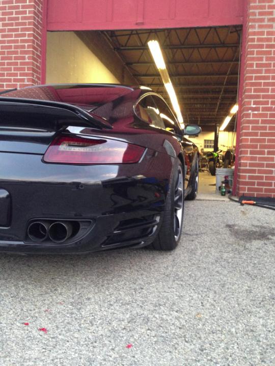

here are my dectanes
i had them lightly smoked

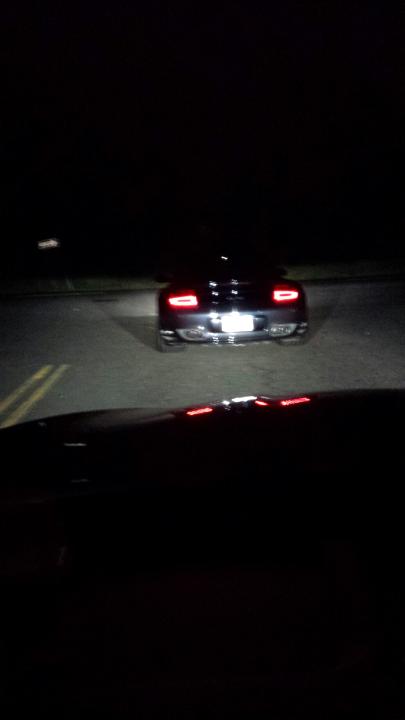

from this morning.
