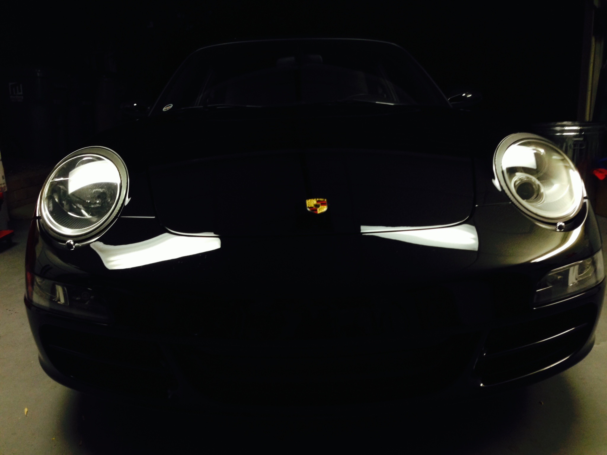

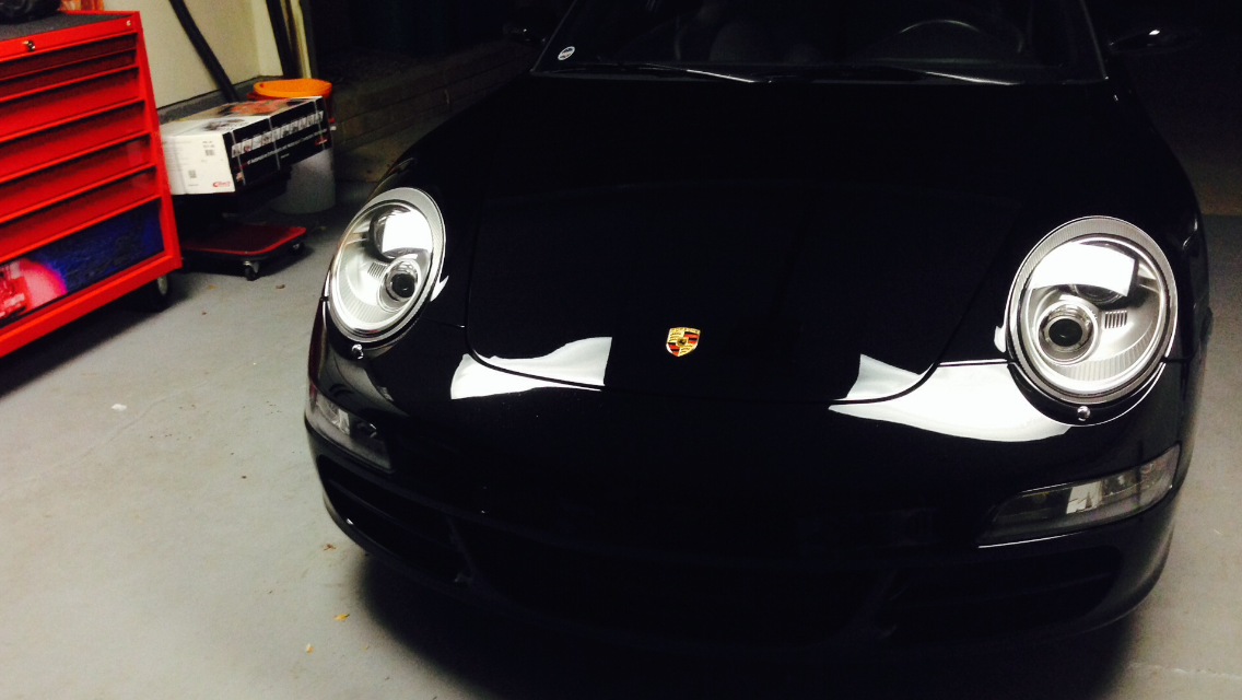

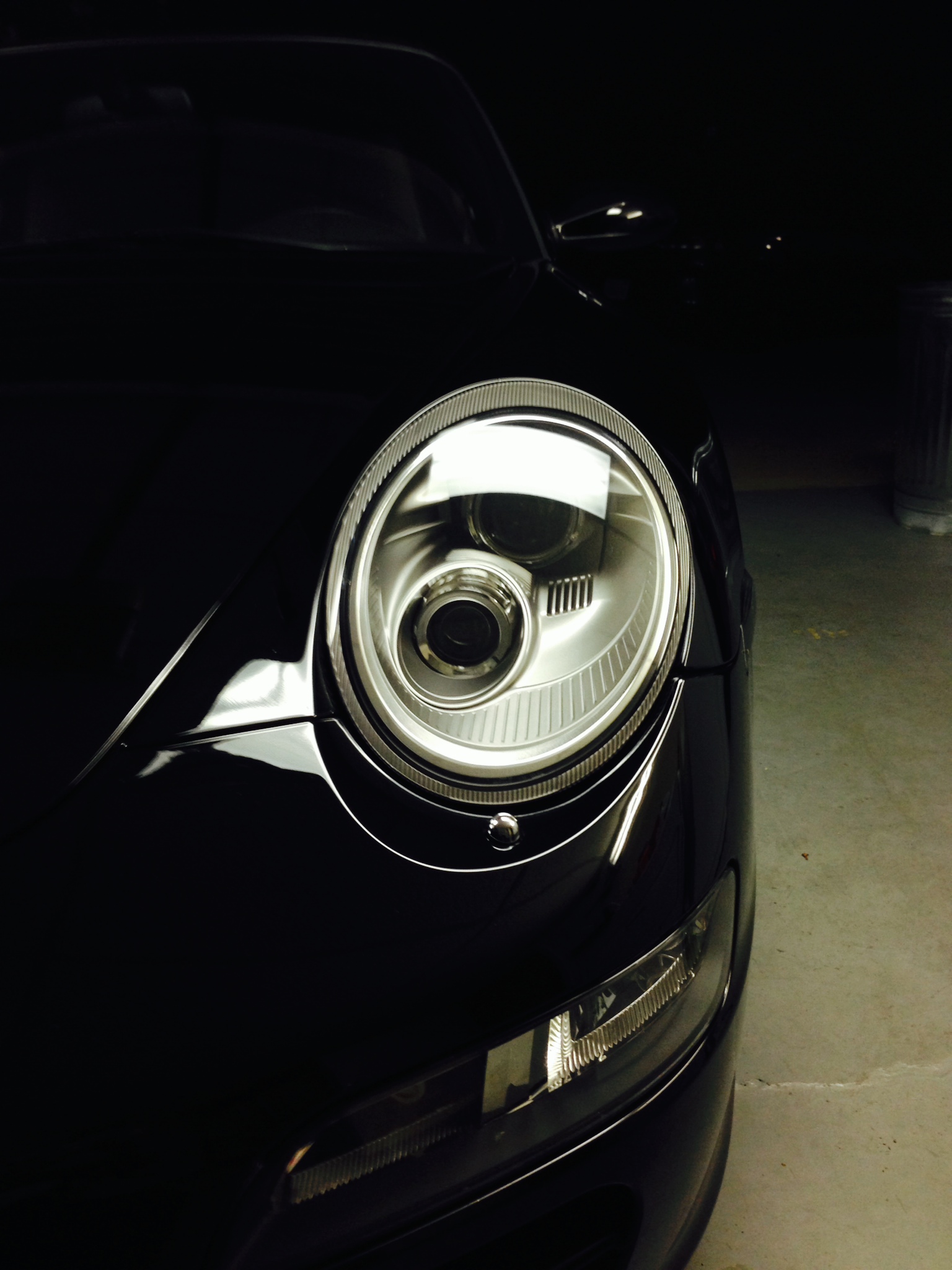

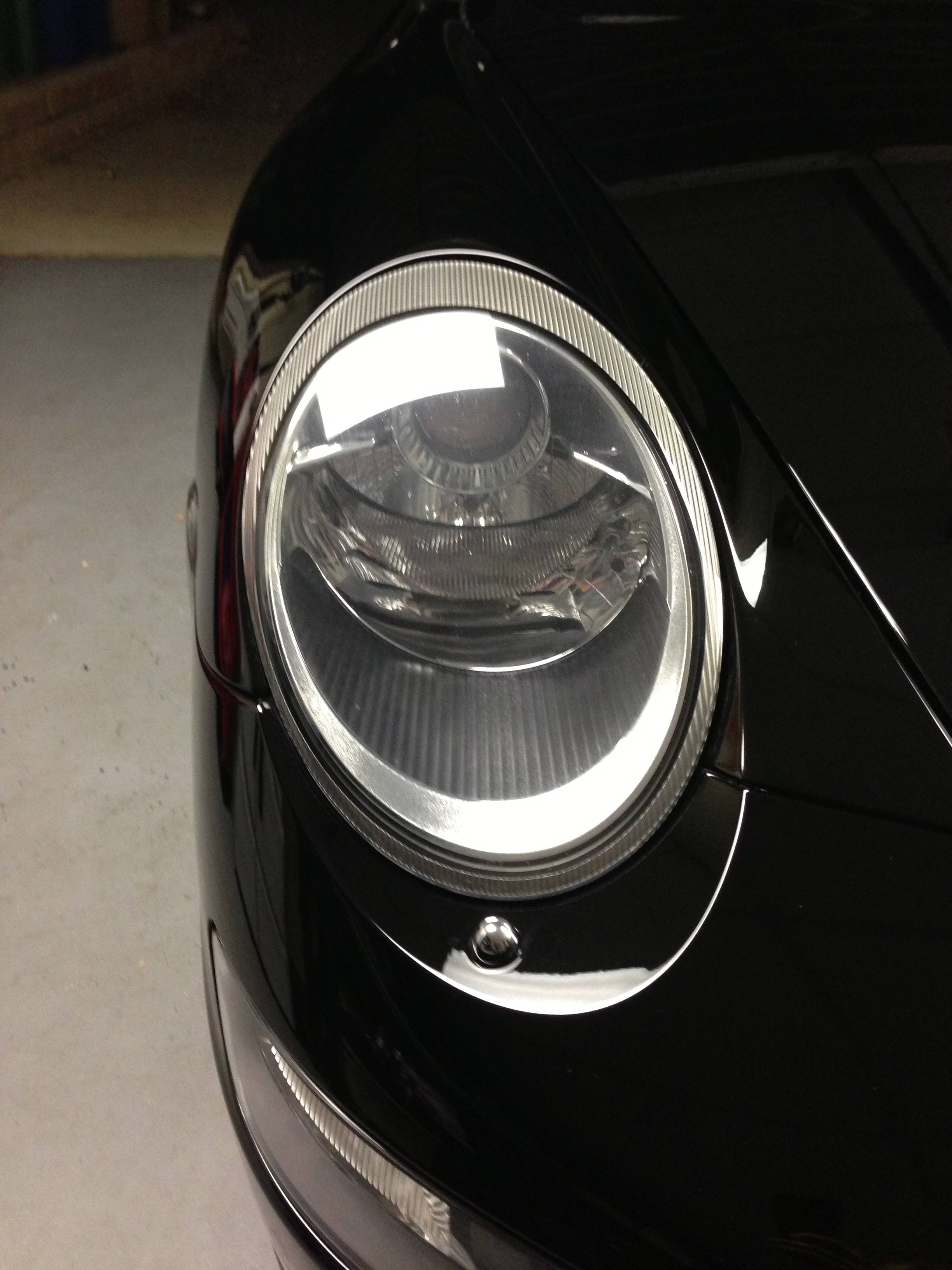

Here are some quick photos to compare old vs new lights.
ID:	282543   Click image for larger version
ID:	282544   Click image for larger version
ID:	282545   Click image for larger version
