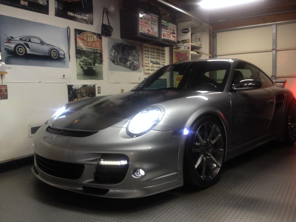

Just did this conversion with a little help from this thread ,def plug & play & pwis error code out ,most used ones come without ballasts but the .1 ballasts do work & so do the .1 bulbs,really updates the look with some real super car headlights.If you keep your eye out you can pick them up fairly cheap buying them on there own instead of in pairs ,which are usually above $2k a pair used & $1750 each new,i got one from Ebay Europe for $500 & one on CL for $400 by doing a nationwide CL search using onecraigslist.com also have the DRL lights & foglight Led & side marker Led to complete the look.

Hello,
I'm new here. Just upgraded my headlights to 997.2. I took it to the local Porsche dealership to get rid of "headlight beam adjustment faulty" error code. They used the PIWIS and we're not able to do it. Does anyone know exactly how this programming is done? I have a 2007 TT. I copied this thread and gave it to them. They told me they spent an hour. Still had to pay the $140.

Originally Posted by NWturbo
I just did this mod, purchased my 997.2 lights from another member here.
YES, it is plug and play. The cornering function will NOT work, and you need to use the PIWIS to reprogram the lights so an error code won't come on.
I believe, using the PIWIS, you tell the ECU that your have cornering function, and the error codes will no longer come on.
Been using the 997.2 lights without any issue for almost 3 weeks now.
Originally Posted by Eavila
Hello,
I'd say your dealer is a retard & lied too you when they said they read the thread ,my tuner was having problems until i showed them this thread ,specifically where it says TELL YOUR ECU THAT IT HAS CORNERING FUNCTION ,i personally watched my tuner go right to this on the Pwis & clear it in 10 secs once he had this info.I also have an 07 they had it hooked up when i got there but couldn't figure it out & asked me to pull up thread & a couple clicks later it was done & hasn't come back on.
Is the automatic leveling function still working? I can't believe this. 997TT.2 Headlights have a different control motor inside, and different wiring compare to 997TT.1.
The only way would be to get rid of the CEL, to program the unit as a halogen unit. But than the xenon are fixed. The best way would be, to replace the stepper motor.
K.
No leveling ability read the whole thread ,you have to manually adjust the lights to where you want them per the instructions in the owners manual.I bought .2 headlights without ballasts & used my .1 ballasts plug & play that simple no motors or anything else needed.
