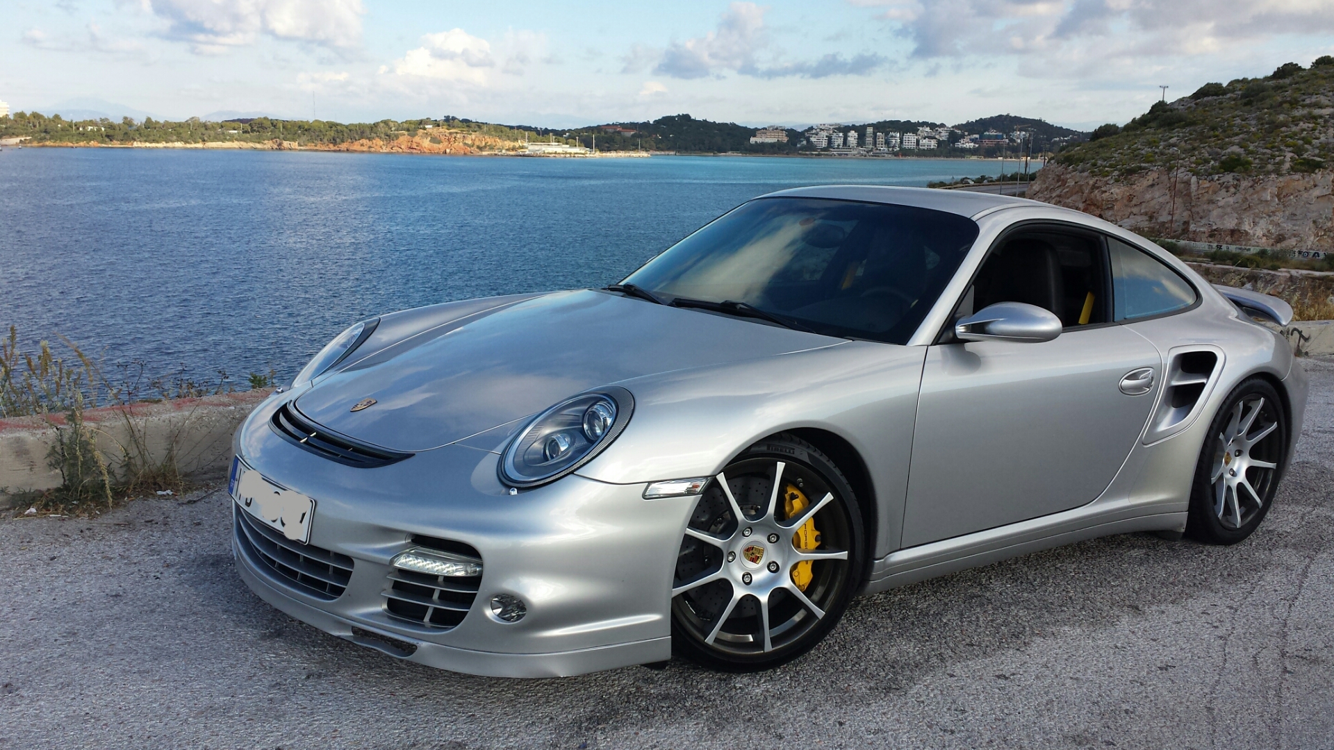

Here is a pic of 997.2 hl installed...

H7 on 997.2 only with cornering lights, without that option uses the H11. Philips also has a 5000K D2S that I like - bright white without any blue or violet tinge - D2S 85122CM (color match). I think I got them on eBay from a UK vendor. What wheels are those - car looks great.

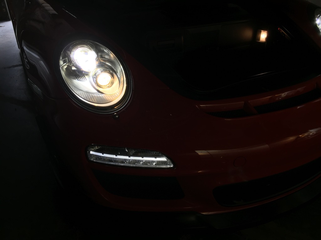

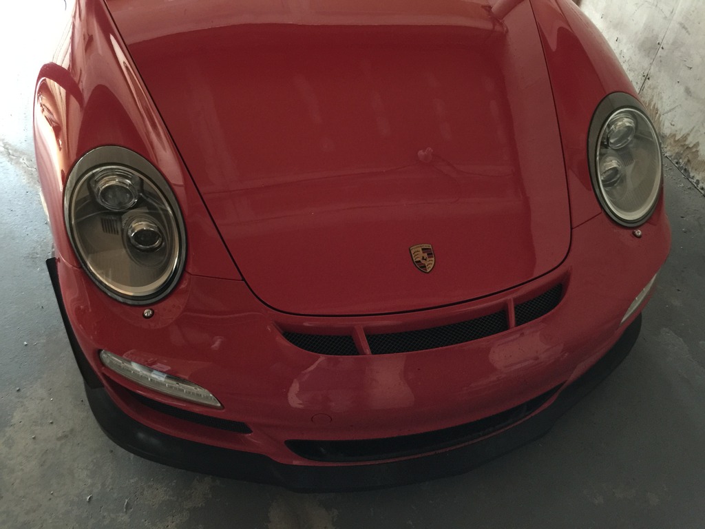

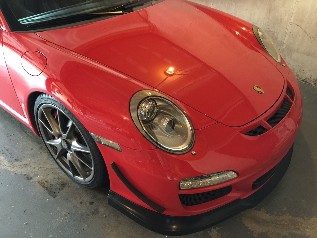

I purchased a set of adaptives for my 2010 GT3 from Germany (my car came with the regular HIDs). Always preferred the cut off and better visibility without dispersion of the ROW headlights so I've been scouring the interwebs for some time. I found this set pretty cheap on the German Ebay and pulled the trigger. Gotta love the cheap Euro.
Installed them yesterdat, it was a breeze. Even added 3000K high beams to cut through mist and fog better.
Beam pattern is great, worthwhile improvement for that alone!
Initially I had an error message telling me the headlight motors weren't working. I re-coded the car with PIWIS so that it recognizes the adaptive headlights and the message disappeared.
Next step is to see if the car has the wiring for the adaptive headlight module and then I'll buy the module itself.
Here's some pics...

And I just noticed that the Turbo bumper washer nozzles are further to the side while on the GT3 they are in the middle. Interesting.
