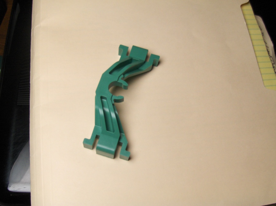

Originally Posted by SuncoastRyan
Guys I felt like I need to chime on the short shift kit vs GT3 shift console.
The GT3 shift console is not a true short throw shifter. It will be the same length in the throws as your current 997 Turbo stock setup, however it does have the billet aluminum bushings.
The short shift kit will indeed have a 20% shorter throw than the GT3 shift console, however it has plastic bushings. Having said that, there has been 0 cases of the plastic bushings going bad (that we are aware of).
Hope my reply helped clear up some confusion.
If you need any other info on the kits we have both parts listed on our website here:
http://www.suncoastparts.com/product/X99742498300.html
http://www.suncoastparts.com/product//997SCU.html
Let me know if we can help anyone out!
Ryan:
When I had the GT3 kit installed(997.1TT) the plastic finger insert that holds the shift lever stationary in order to "set" the cable lengths definitely has a different profile from the original which does dictate a difference in the throw. This is a great addition and the aluminum bushings are nice to have and are very smooth. I don't know what the percentage difference is in throw but there is a difference. As I recall the new plastic insert has a lower(?) profile than the OEM.
I hope I am making sense. And I hope you might explain this for the guys and me following this thread.
Ed

Originally Posted by clay5523
Ryan:
Ed
The GT3 shift console will feel different than the shift console in a 997 TT, that is because of the bushings. The GT3 being a shorter throw, I cannot confirm that. As far as I know they are the same distance... Like you said it could be a small percentage shorter, but I do not have any info from Porsche stating that.
What I do know is the short shift kit will be 20% shorter throw than both the 997/997TT shift console and the 997.2 GT3 shift console. That has been clearly stated by the information provided by Porsche.

"There are 3 shift consoles...
1- Stock 997 Shift console (same for sall 997.1-997.2)
2- 997.2 GT3 shift console with the aluminum bushings (not shorter in throw)
3- Short shift kit same for all manual transmission cars (even the 996-986).
Ryan: Since you have easy access to all three assemblies could you please post the part # for the part in the picture below. This gage is what holds the shift lever in place while the cable lengths are set. Curious to know if these numbers are different for each console.
