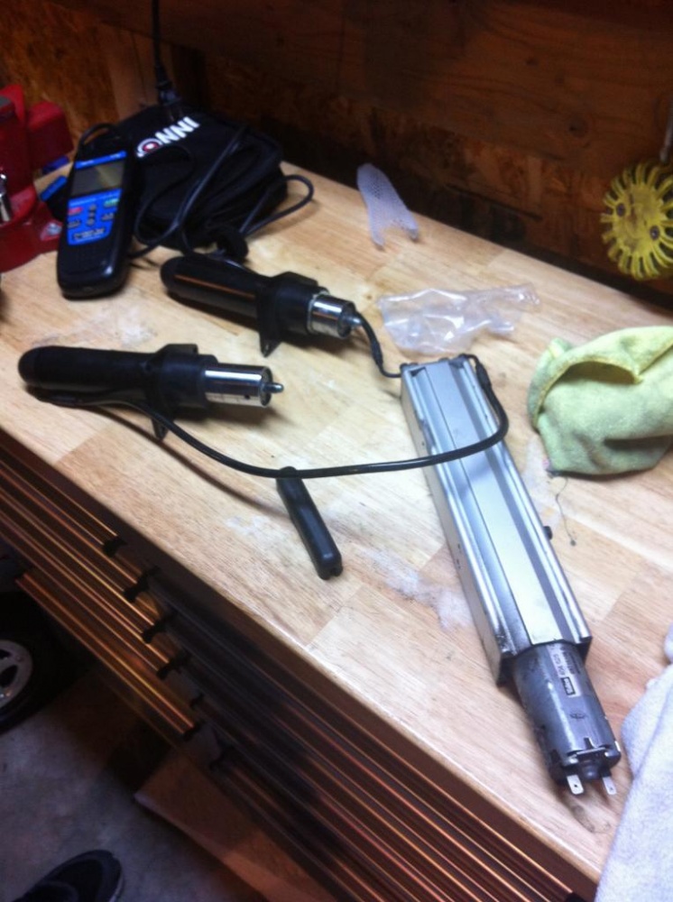

Originally Posted by johnww
***You say wing is fixed....how did you do that??
Sorry, meant to say it's "permanently in a fixed position".
I removed all the hardware and installed the fixed posts from ebworks. google them or search 6speed. $150 or so and you're good to go, plus you can choose about 3 different levels for the spoiler.
You then have to have your ECU flashed to make your car think it's a GT2 or you'll get a warning message whenever you go over 75mph.
I wasn't about to shell out $2300 for the wing to go up and down... not at this point anyhow. Especially for a system that will basically fail every 4-5 years.
Not sure about the rebuild company, but it's out there... much more reasonable at ~$1000 but still not something I wanted to bother with.
system removed...
Good luck! Here's my wing in it's permanent position (which is actually one of the lowest, which imo was perfect for the aftermarket wing):

The struts that DrVolkl used are not hydraulic.
He removed the hydraulics, actuators, tubing, then installed ebwerks fixed struts. Once the wing is in a fixed position, he prevented CELs by turning off the wing using Durametric or PIWIS.
drVolki.....appreciated the photos. Looks like you're saying one can't use the factory wing via the eworks system. Sure looks complicated, it is not simply replacing wing. You gotta replace tubes that are attached to wing...did you just cut and plug hydraulic lines?
Not saying that at all. You can use your stock wing and have it in the down position, up position or somewhere in between or even higher than stock.
The stock hydraulic system looks complicated but is easy to remove. I work on my own car a lot, but "I'm a Dr Jim, not a Porsche mechanic!"
The most complicated tool is your spoiler wrench... that costs about $90. You need that to unscrew the stock wing. After that, if you go the ebworks post route, you won't need it ever again.
Your ebworks threw me, but threw google too, which surprised me, because the google usually picks up on different spells.
However, ebwerks gives very little on their products on their webpage, but was very helpful via email, providing a phone # for installation questions, but too have full instructions on way. Product sounds like winner. Just happy to get rid of this infernal leakage/worry/expensive issue with the rear wing. The parts use factory wing and same factory height setting which are great features as well.

Originally Posted by f1crazydriver
Hopefully Bob wont mind me posting this... I got it from another thread....
Draft beer faucet wrench works. Super cheap too ~$4.
http://morebeer.com/products/faucet-...html?site_id=7
That right there is awesome... as long as it works! Huh... go figure.. Porsche engineers using a draft beer wrench for the spoiler. I have to imagine that was somehow planned. lol
Yeah, ebworks guy was super helpful to me as well. I looked into the refurbish and they were nice and helpful too. I just think the design is flawed, and for $2300 I'd rather buy something else right now. After I went with an aftermarket wing, I really didn't care if it went up or down, I just picked the position I preferred best and left it there. One less thing to worry about. Oh, and the weight savings off the back of the car?! Priceless. (I know it's negligible but every bit counts )
