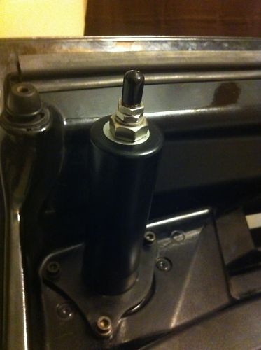

bbywu: not sure what your photo represents? Did you have other photos? And too, what do you think of the idea of just drilling 1/16 inch holes thru pipes just above the outer female-sleeves when wing is up position and placing dowel pins in these holes to permanently hold wing in up-position?? With this set-up, just never press the button to raise wing. This way there may be no oil pressure inside also saving wear and tear on the costly pump.
What are your thoughts on the mechanism of wing? Oil pressure raises wing? There was a suggestion that along with oil, there was some spring action....not sure why a spring would be needed, that is to help assist the up or down movement???
