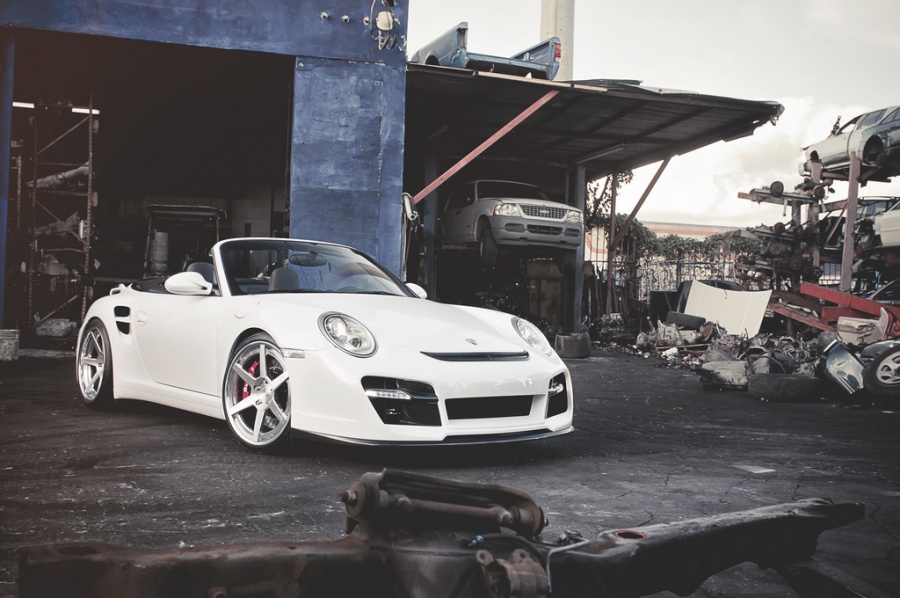

Here was out inspiration for the car... this one has champion springs (which I believe are H&R) I just don't know why springs wouldn't "work" on our car.
That IS an inspirational picture. I just put GMG springs on my car and I have PASM so I'm not sure why it wouldn't work (mine is a .1 vs your .2 though).
I think the H&Rs pictured above lower the car slightly more than the GMGs but it is close.

Heyyyy Mini....that shop is totally wrong. You definitely CAN use springs on a PASM equipped car. In fact, the Turbo S you posted of ours has H&R's on it. We have them in stock.

here is my 2012 lowered on HR no problem and i have easily done 20 plus 997.2 on HR again no problems .
