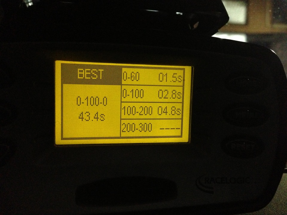

I make some street tests on pump gas, 1.4 bar of boost +28 C
Dont forget car had no porting, stock turbo intake manifold and 3.6 ltr engine (only carrillo rods and arp head studs)
Here is result

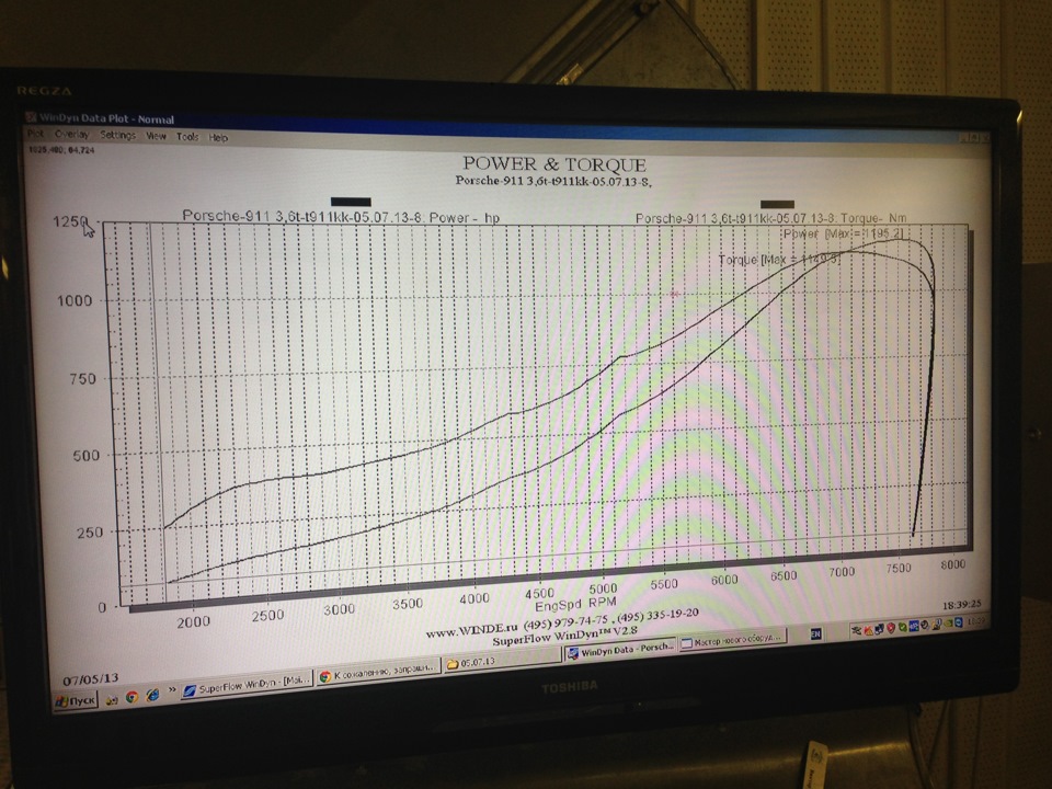

Result is 1195 hp or 1000whp on 2.1 bar of boost, increasing of boost didnt make effect, turbos is maxed out, Rayan says that i need head porting, what do u think?

Camshafts are also stock I guess...

Hi guys, I have made some tests on straight pump gas so:
One run from launch, boost 1,4 bar
0-100 is 2,8 sec
100-200 4,5 sec
60-130 5,1 sec
100-150 5,1 sec
1/4 mile 10,0@236kmh(147mph)
1/2 mile 15,4@286kmh(178mph)
Soon some retune and race fuel at 1,7 and 2,2 bar
IAT was under 40C... AMS IC works perfect!
