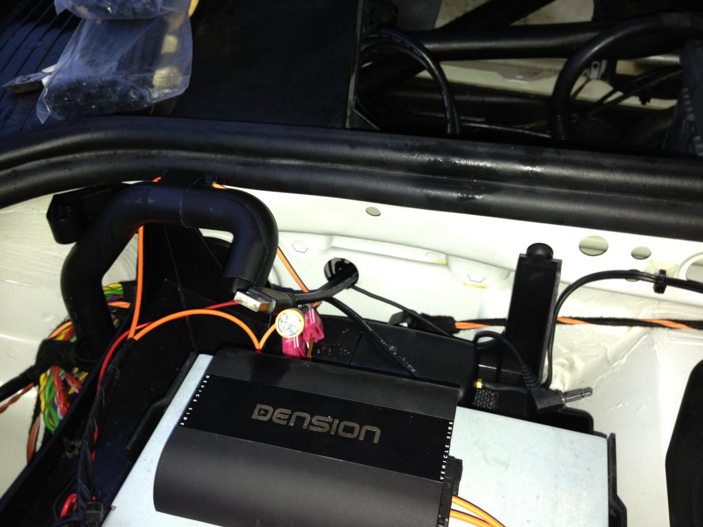

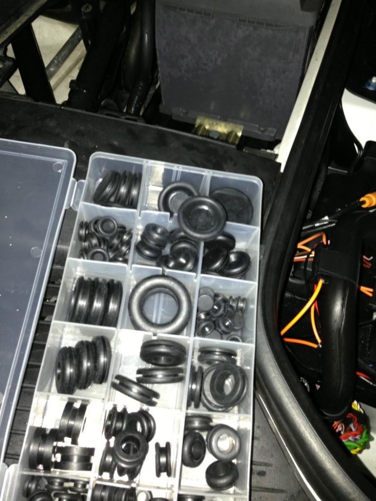

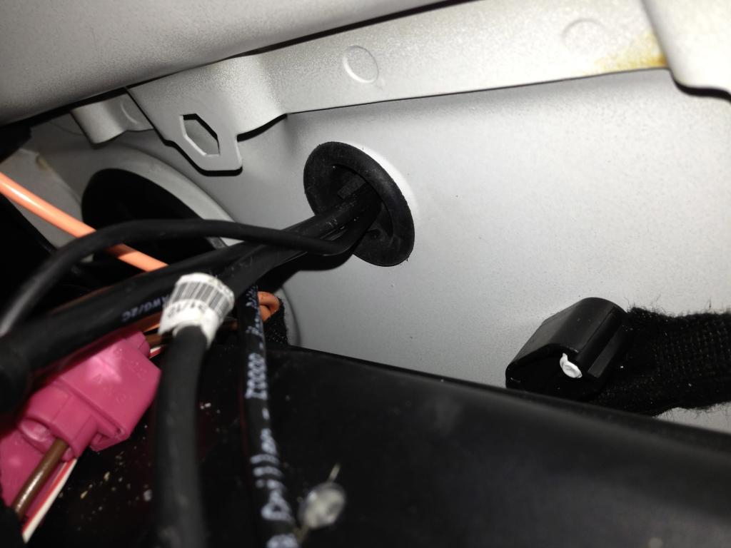

I found the large grommet between the front firewall and the cabin (behind the battery and to the right).
However, how should I run the cables from the frunk to the battery compartment area? Is the only option to drill a hole in one of the molded grommets that already contains a large wire bundle? Or is there a grommet that is also unused from the frunk to the battery?
Update: So it looks like I have to remove the carbon canister (black box under the CD changer) to give access to the unused grommet that is just behind it.

I have my Dension mounted with velcro on top of the navigation dvd player. There was a small hole with a piece of plastic close to it, I drilled it up in size to fit the usb connector to the Dension unit. Before pulling the cable through I put a new rubber grommet in the hole I drilled and ran the cable through it.
