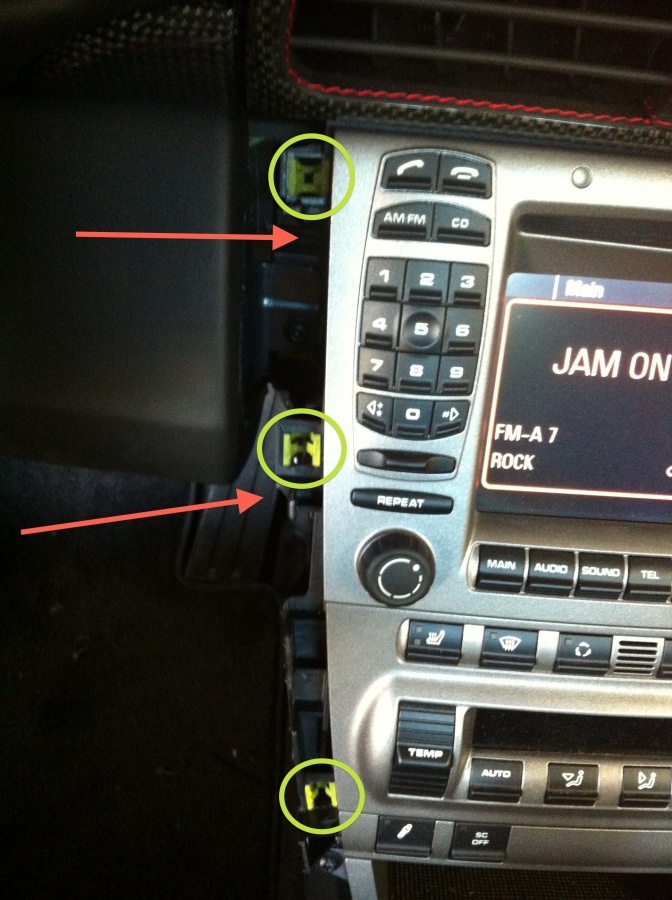

Next, you will need to pull the lateral covers on both sides of PCM. They are held with Torx T-20 bolts, two each side. To pull the cover, you need to pull forward, and unsnap 3 speed tabs located here (yellow circles.)

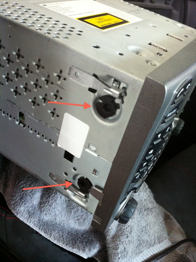

Next use a 5mm Allen key and turn counter clockwise 4 plastic locking tabs, located here: (red arrow)

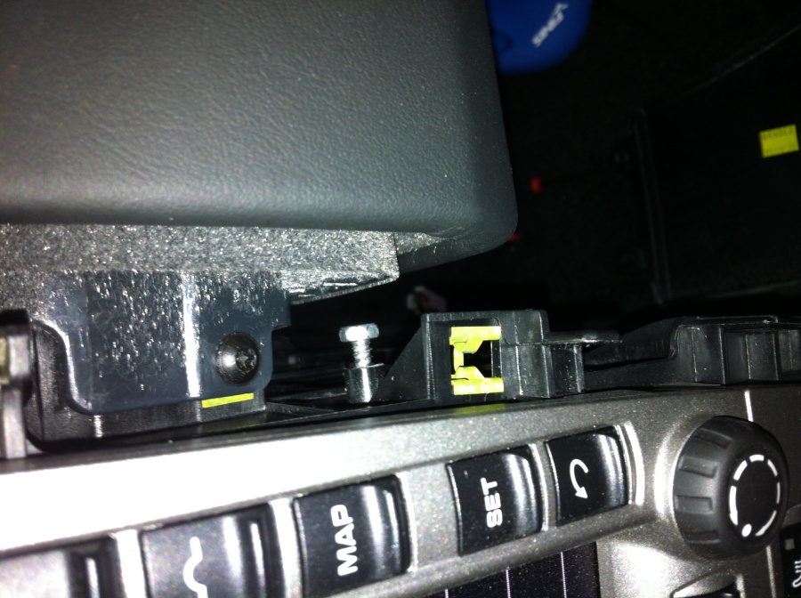

Use a small 7mm hex socket and loosen the locking bolt on the passenger side:

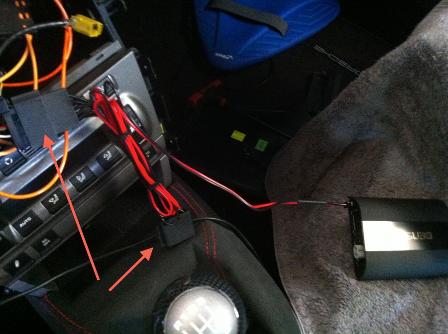

Pull PCM and unclasp the wiring - one for MOST, 1 for PCM, 1 for power, and 2 for the antenna.
Hook up appropriate MOST wiring.
I decided to reuse my wiring harness from the GW500. I also had a custom wiring harness to tap power so I didn't have to wire tap directly into factory wiring.

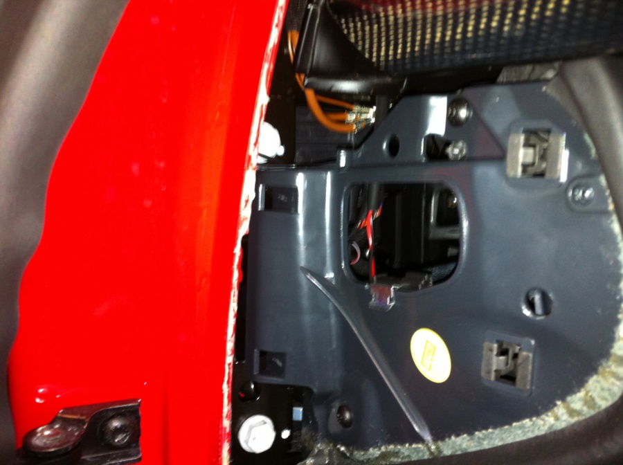

I ran my adapter wiring through a small opening into the glove box. I pulled the light and used the factory opening to pull the wiring into the glove box.

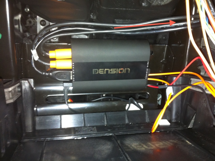

Installed:

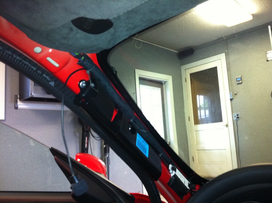

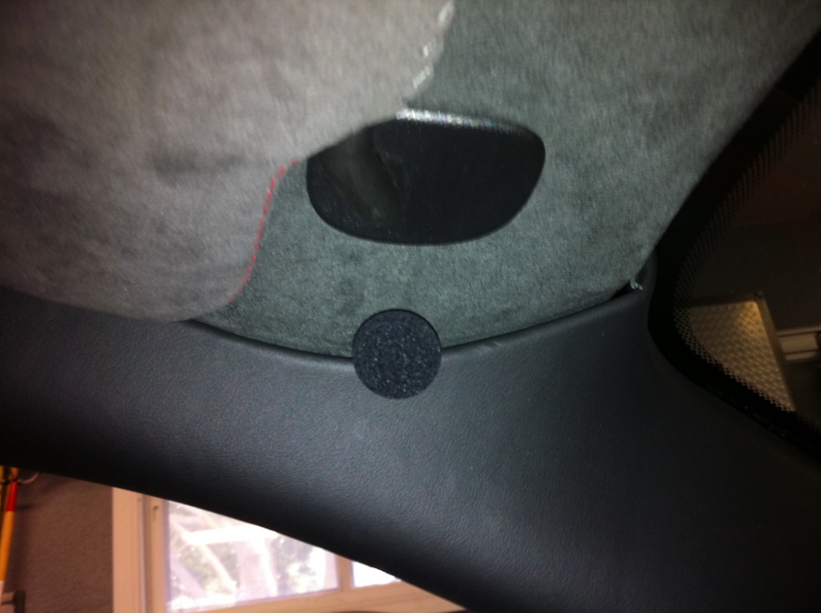

Bluetooth wired under the dash, out the A pillar:
