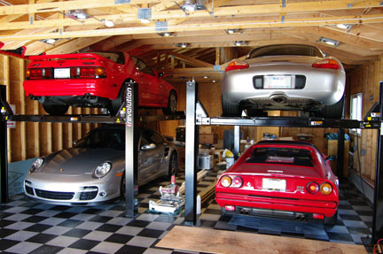

We purchased two Revolution lifts (made by Rotary) that have been excellent. As stated above, these 4 post lifts are not ideal if doing service is your main objective (depending on the service), but they are well suited for storing vehicles.
The critical thing when storing, is to ensure you have the ceiling height, which will of course depend on the vehicles you intend to store. We store two sports cars one above the other on one side and then a sedan and very low sports car on the other side. We used the calculator from Revolution to account not only for the car heights but the elevations at which the lift locks, and the suggested minimum clearances.
In the end we decided we had to raise the ceiling, and although I am an engineer, I am not structural engineer, so we hired one to do a drawing (given concern for snow loads, etc.). We then sistered the rafters and collar ties to the trusses, nailed and glued them and then cut away the low hanging trusses.
It has been six years and the ridge line of the roof looks perfect, and we have all the height needed to store our cars.

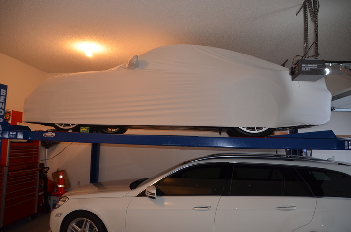

I turned my two car garage into a three car with the Bend Pak HD9-st.
Ceiling height is ten feet and it will store the turbo S with no problem.
I do all my oil changes on three cars and can clean the undersides very easily.
Excellent capacity, 9,000lb.

Bend Pak Pictures

We are using our garage to store 6 cars, two on lifts, two under, and two in front. Although you indicated you had the height, there may be others that have ceiling issues and this picture prior to finishing, shows the area of trusses removed and replaced by rafters and collar ties to provide the needed height
